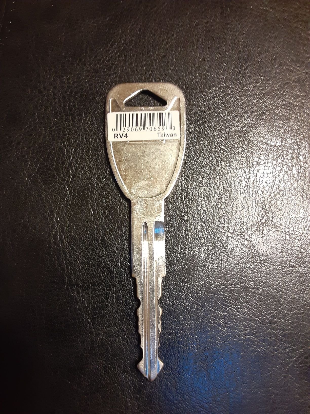

ace hardware has the key blank and will cut it for like 10$. Then you cut the new 'end' off to same length as old one, and drill tiny hole, and replace it into working fob locking block with press pin...

key blank RV4:
this one was cut at Ace hardware of the stock fob key...

key blank RV4:
Whey I bought this truck earlier this summer, it already came with a cheap key blank cut into a key, that's what I had from the get-to. In fact, I then made a second one, although it cost me $16-17 at a kiosk in Walmart. So in this thread, I am talking about a complete, new, working key fob; I had a locksmith cut the key blade on the fob, and it works fine AS A KEY, but now I need to program the actual FOB. Haven't got around to it yet.
