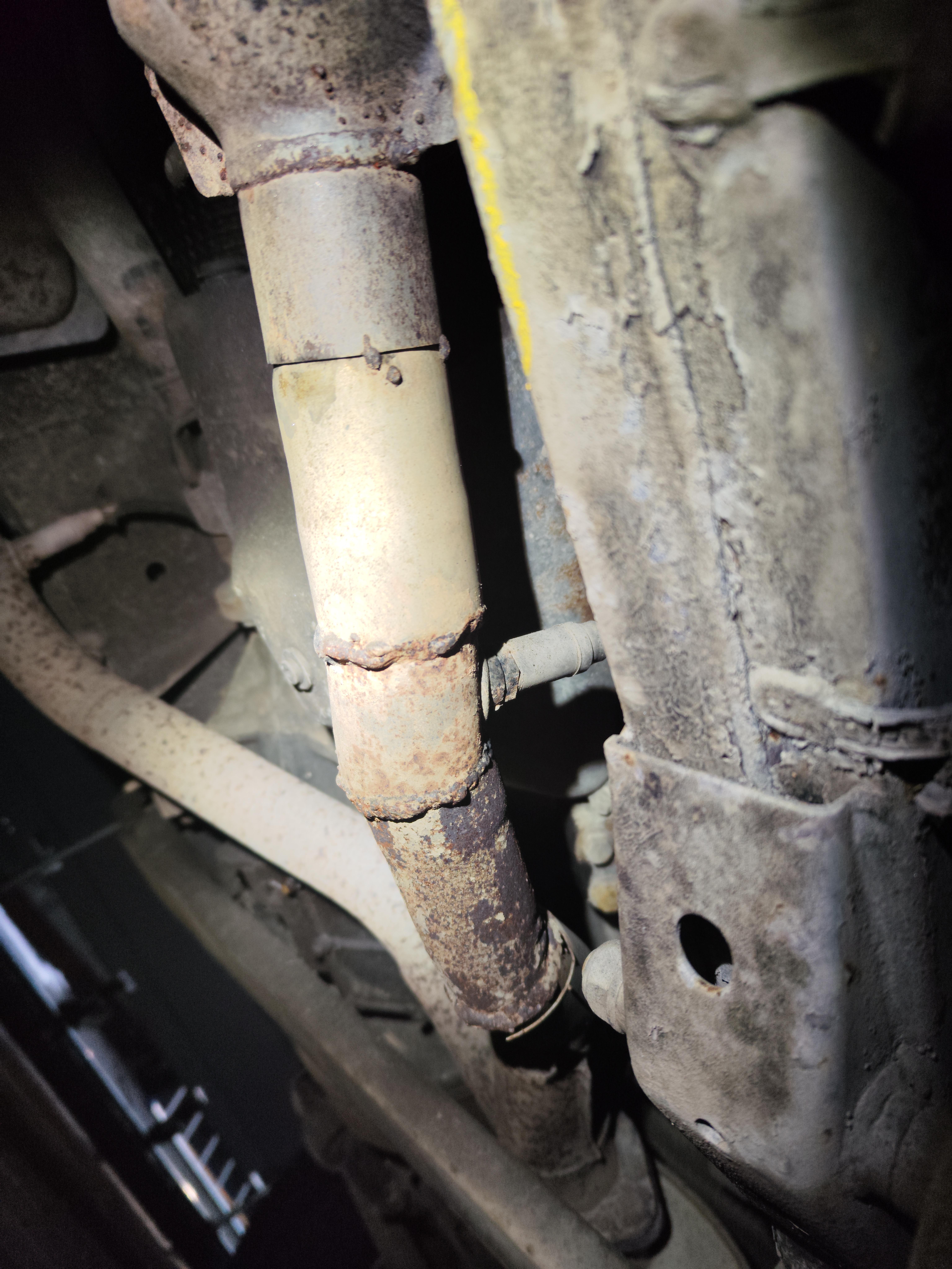

The exhaust is not completely shot, but previous owners have done enough botch repairs on it so we want to get a completely new one.
....and make it sound better. Not gonna sound like my 91 mustang wit long headers, x pipe and slp loudmouth, but better than stock perhaps.
This is just one spot

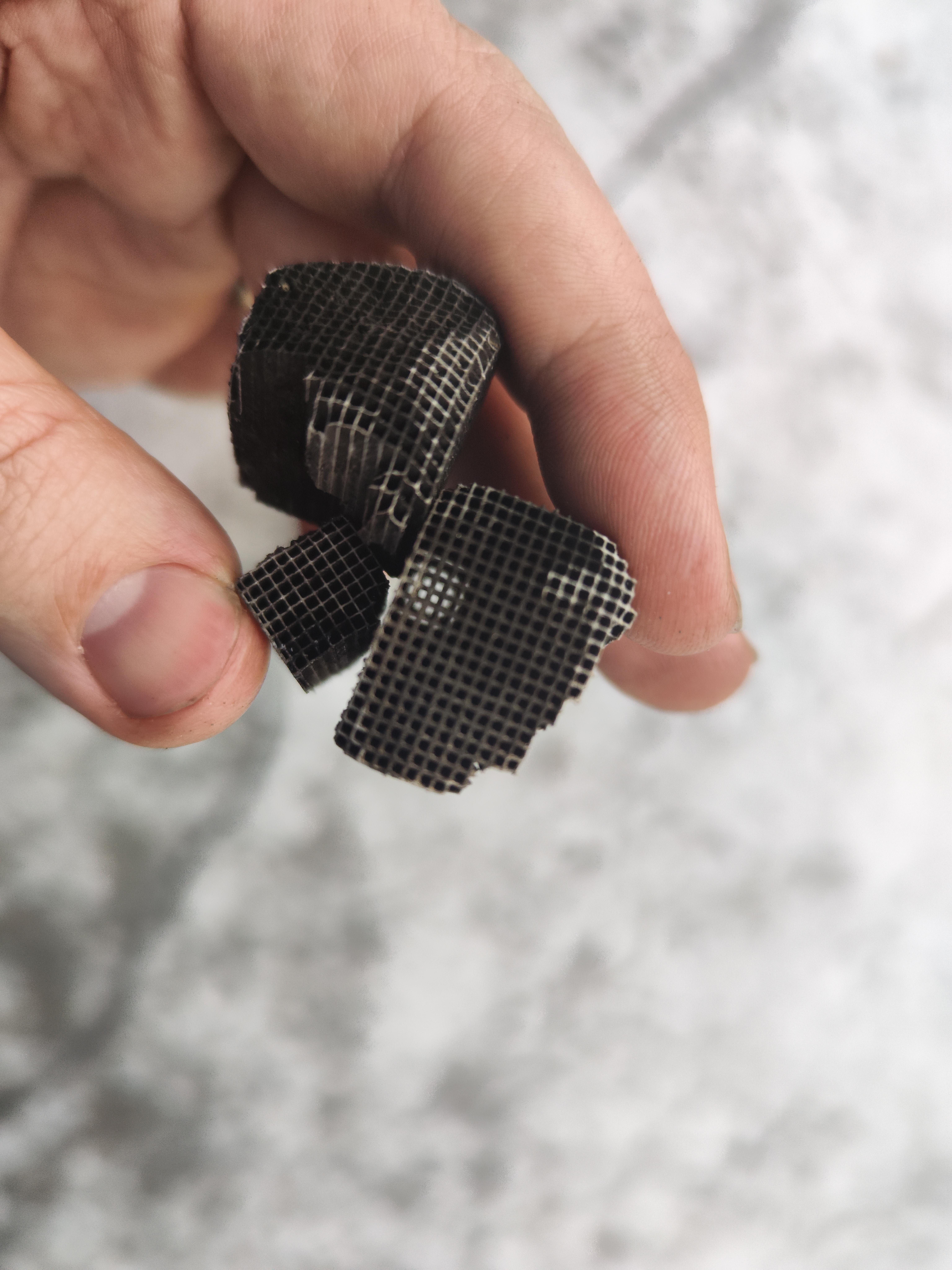

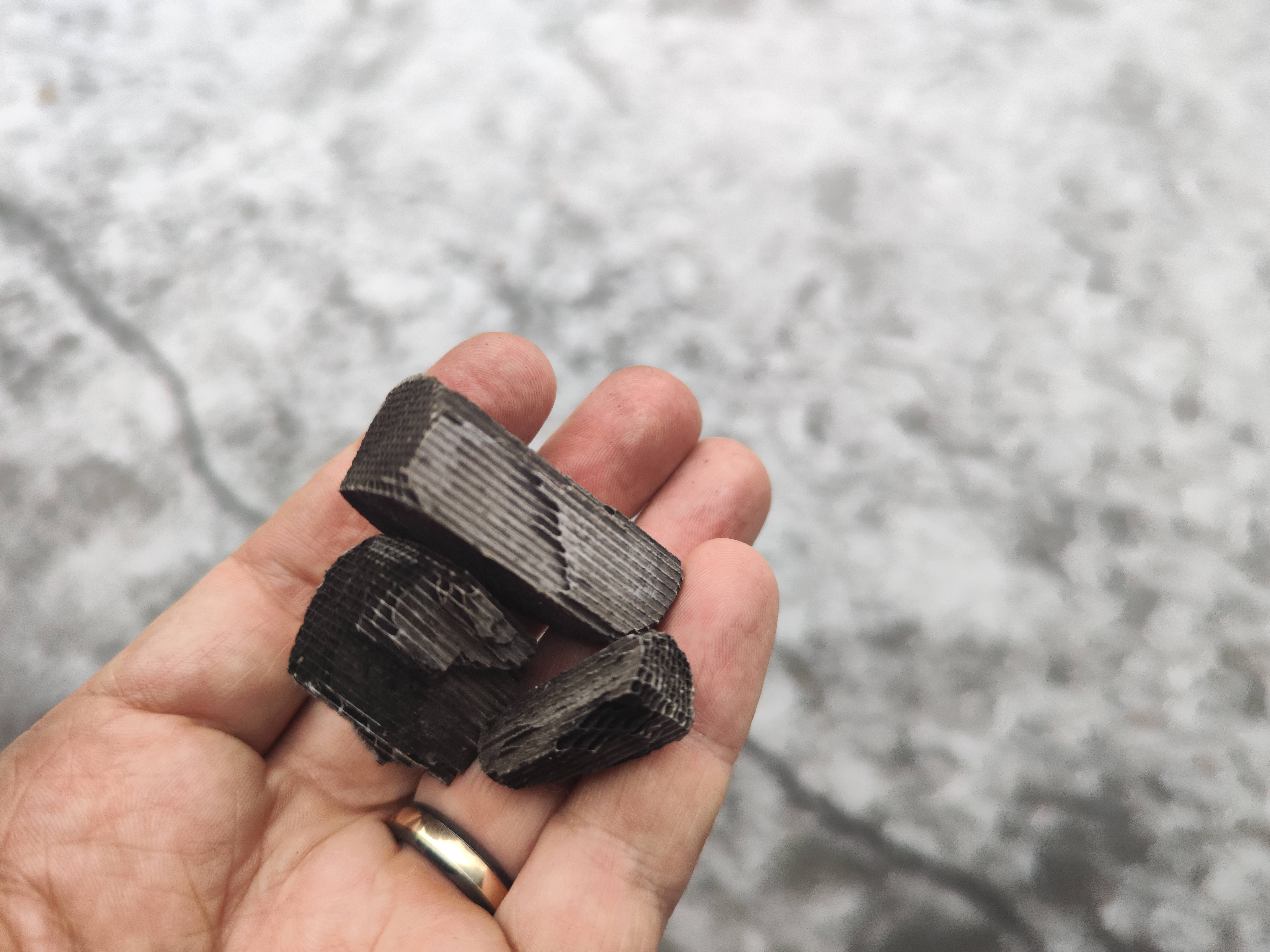

Oh, almost forgot.
The cats are definately on their way out, literally.
Found these on the ground behind the truck today..
