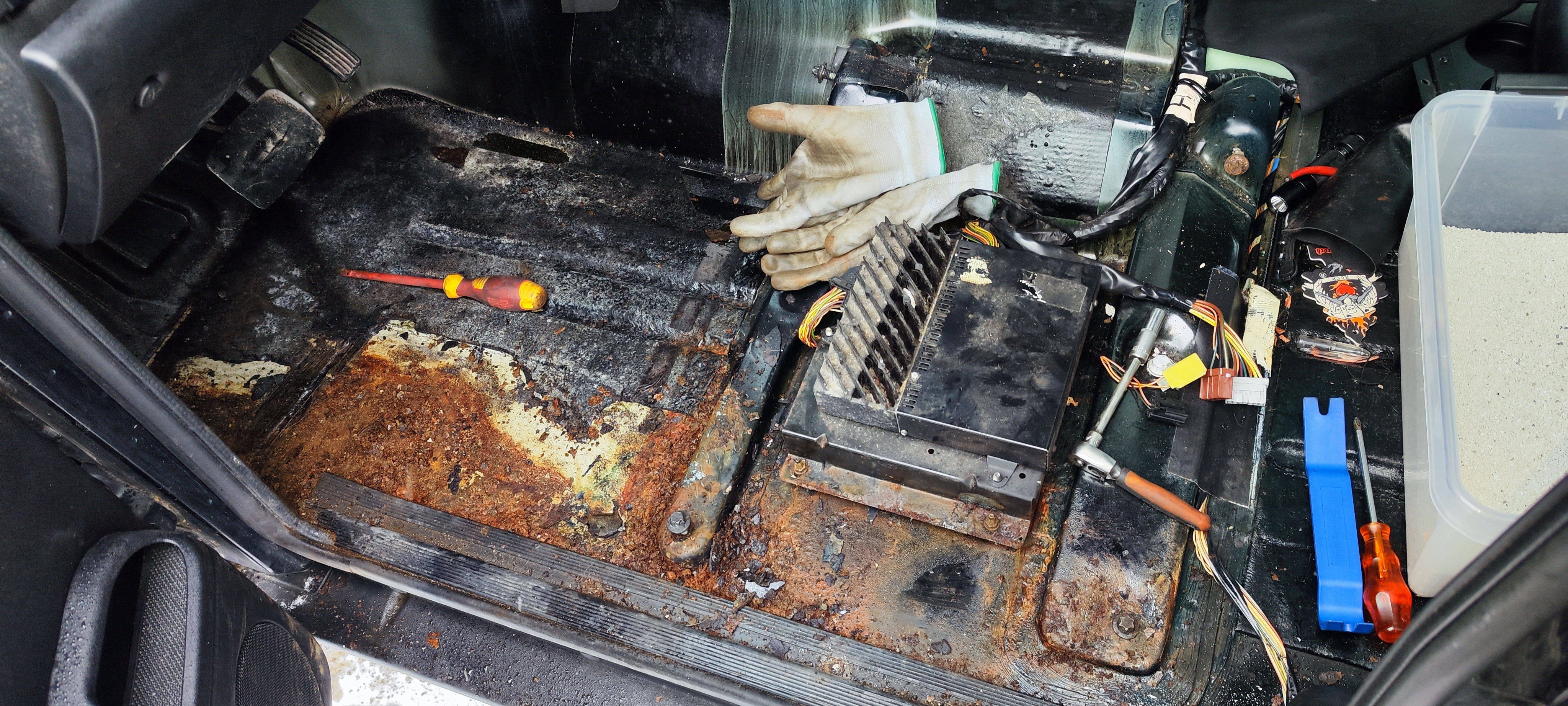

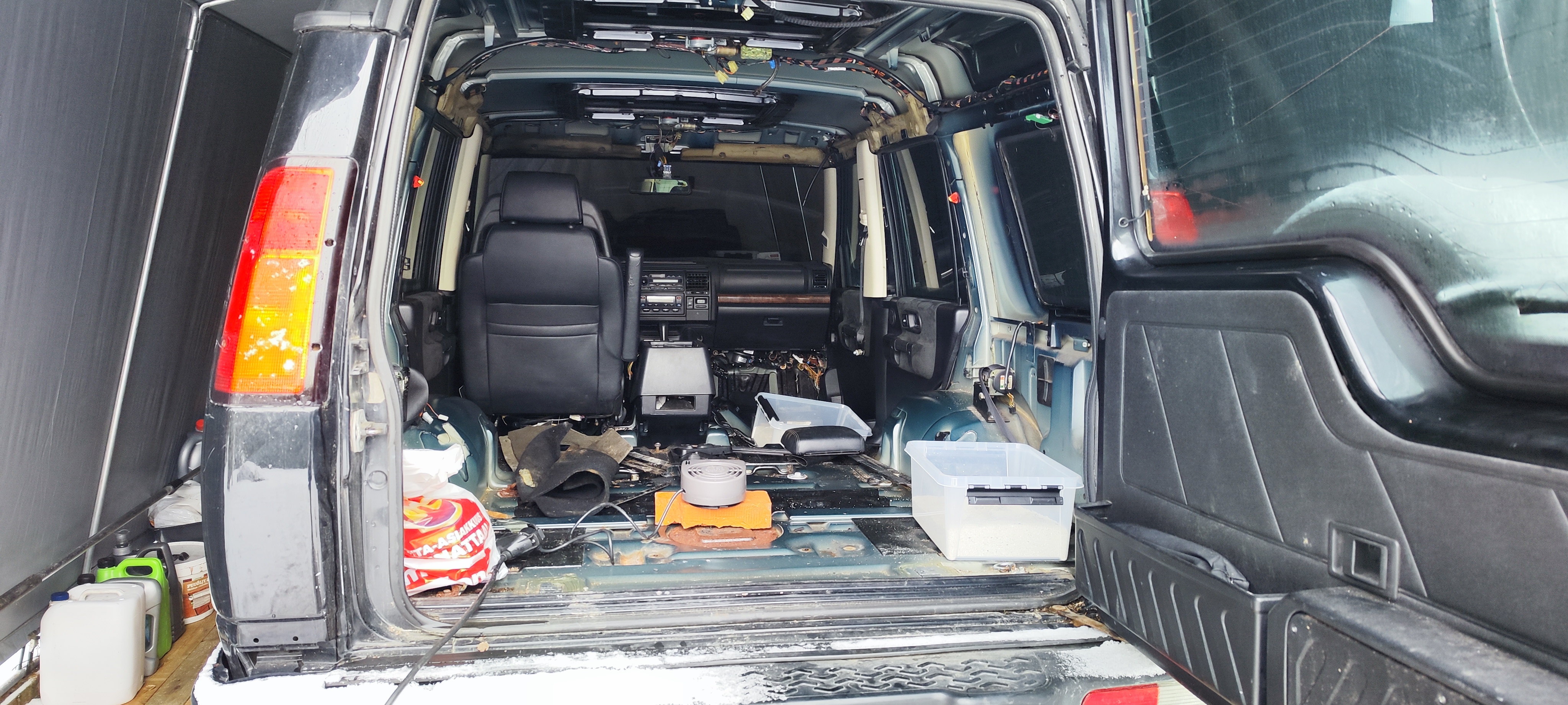

Stripped her down from inside and oh boy was the front carpets wet. Umm, well, frozen solid.
They've been standing up in the sauna since yesterday dripping water.
Trunk carpet was best, not really even wet.

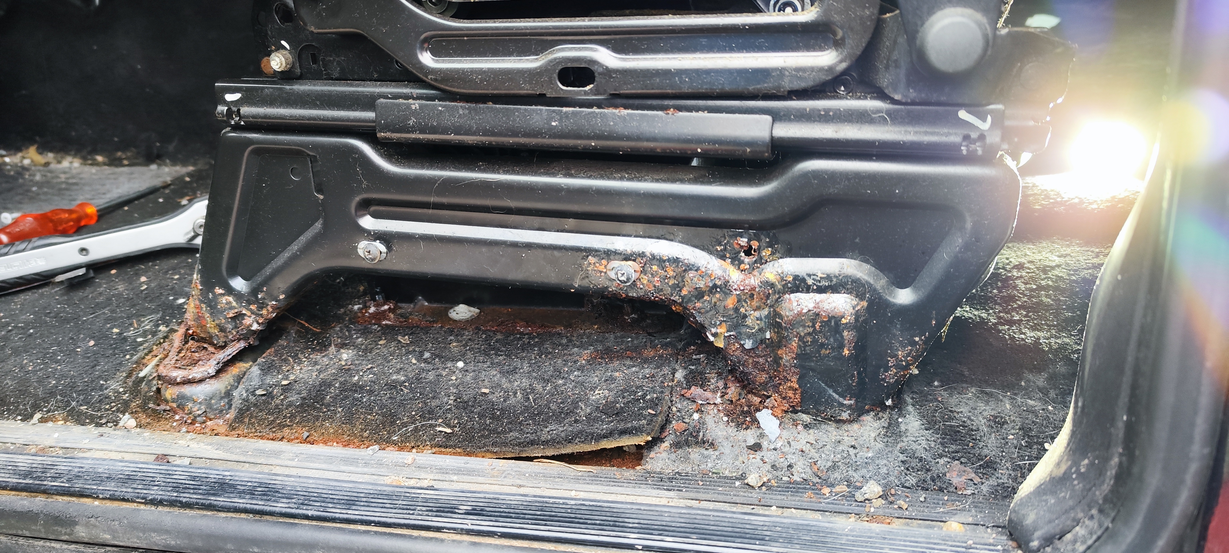

Drivers seat frame.. legs, whatever.. looked kinda bad.
Plenty of mainly surface "fordium" present. I knocked around and all seemed solid. Just need to properly clean up and paint.

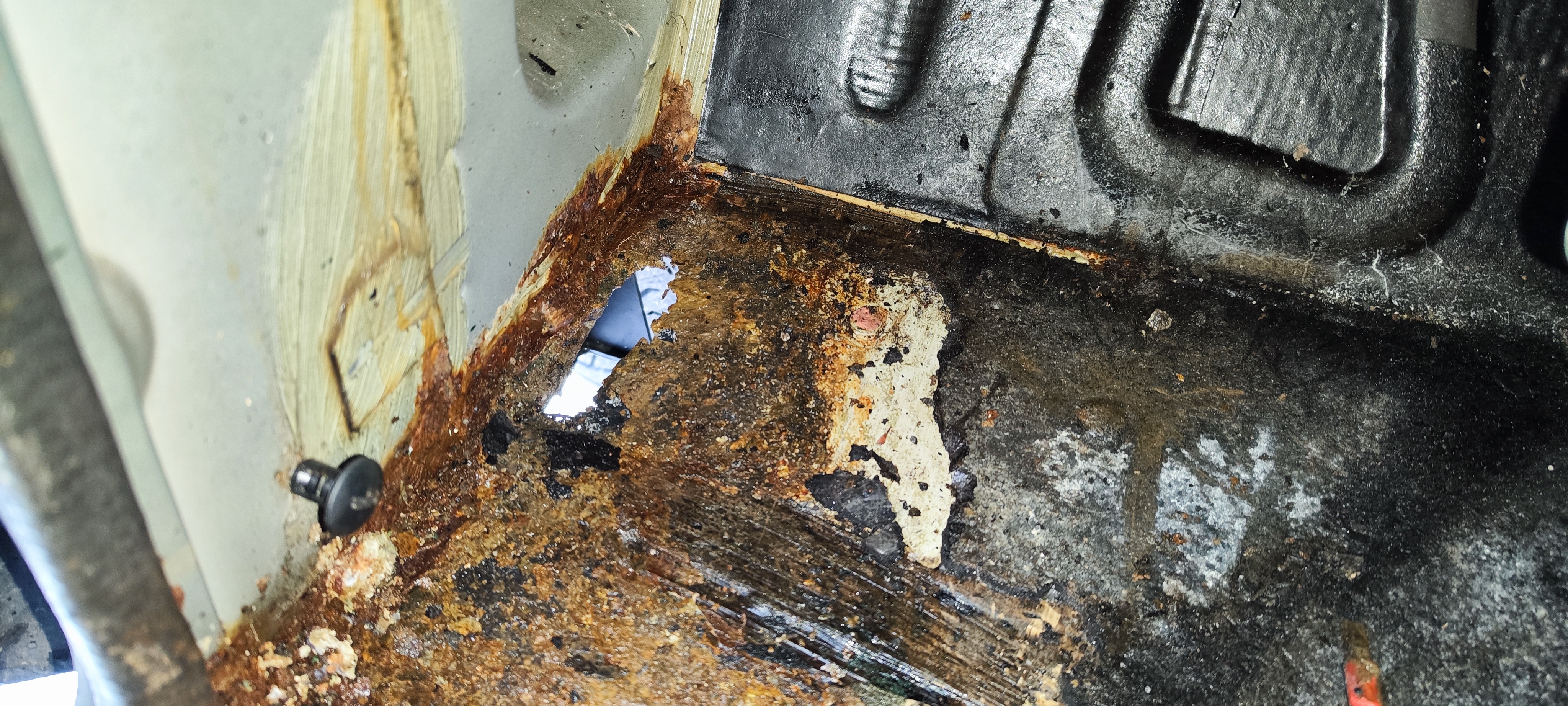

I quess the truck has been sitting a long time tilted left and front as there really was nothing elsewhere than this corner.
And here's what not so good anymore. Will be fixed next week, ie I pay someone to weld this and the small front chassis rot.

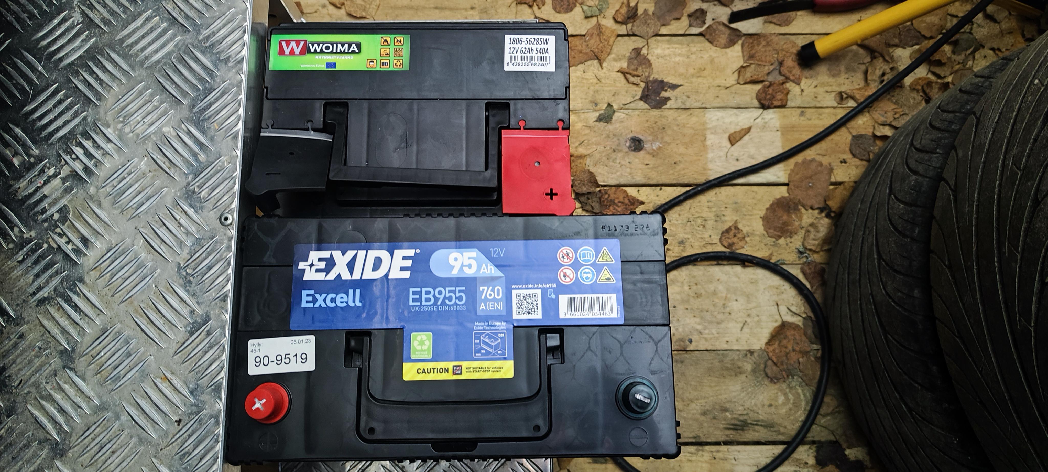

Also put in a new bigger battery to replace the one previous owner put in just before we closed the deal. Cheapest smallest possible he apparently could find. And with the terminals wrong way around.
