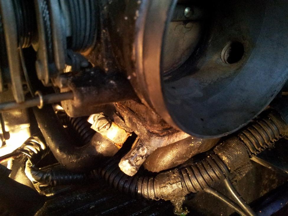

Drove almost an hour to get to the dealer to find out the parts dept closed 15 minutes earlier. I did find out though that the throttle body gaskets leak. That may actually be my problem. I wish I had known that prior to breaking this coolant line.
Looks like I better replace the gaskets and the plate along with the line and then I'll be fine. Much better news than head gaskets. Good thing I ran into the Service Manager.

The Service Manager I met has been with Range Rover 17 years and he is the one that told me to replace the gaskets and the plate. He said it is a known issue. He also said the trucks are bullet proof. That was encouraging news. He also mentioned that the Parts Manager has 2 Discoverys. I got to get to know that guy.

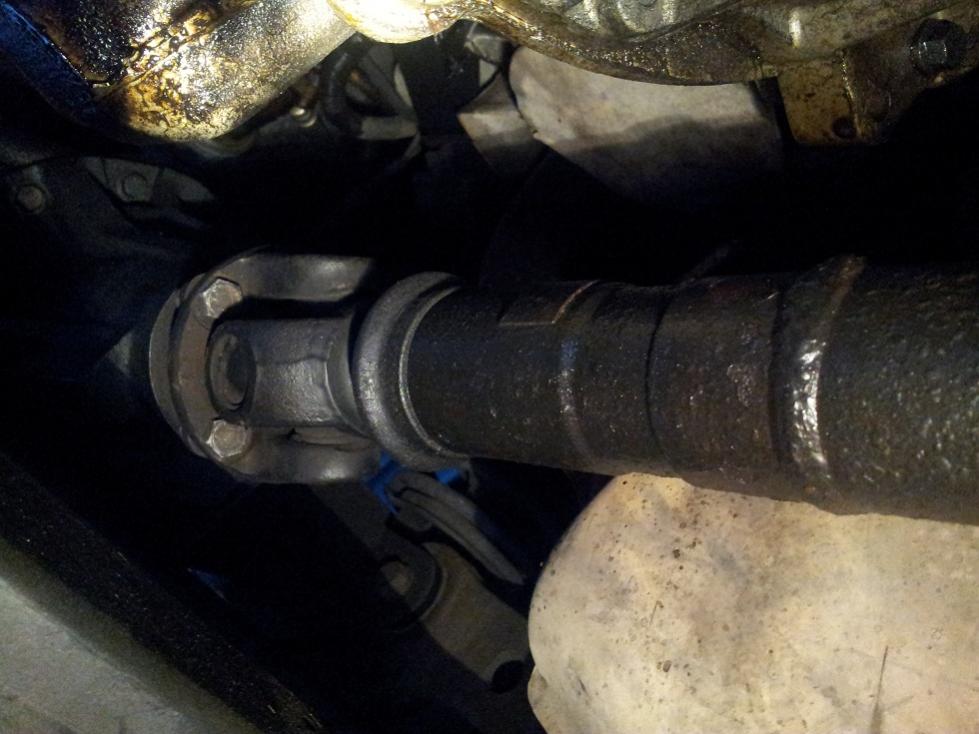

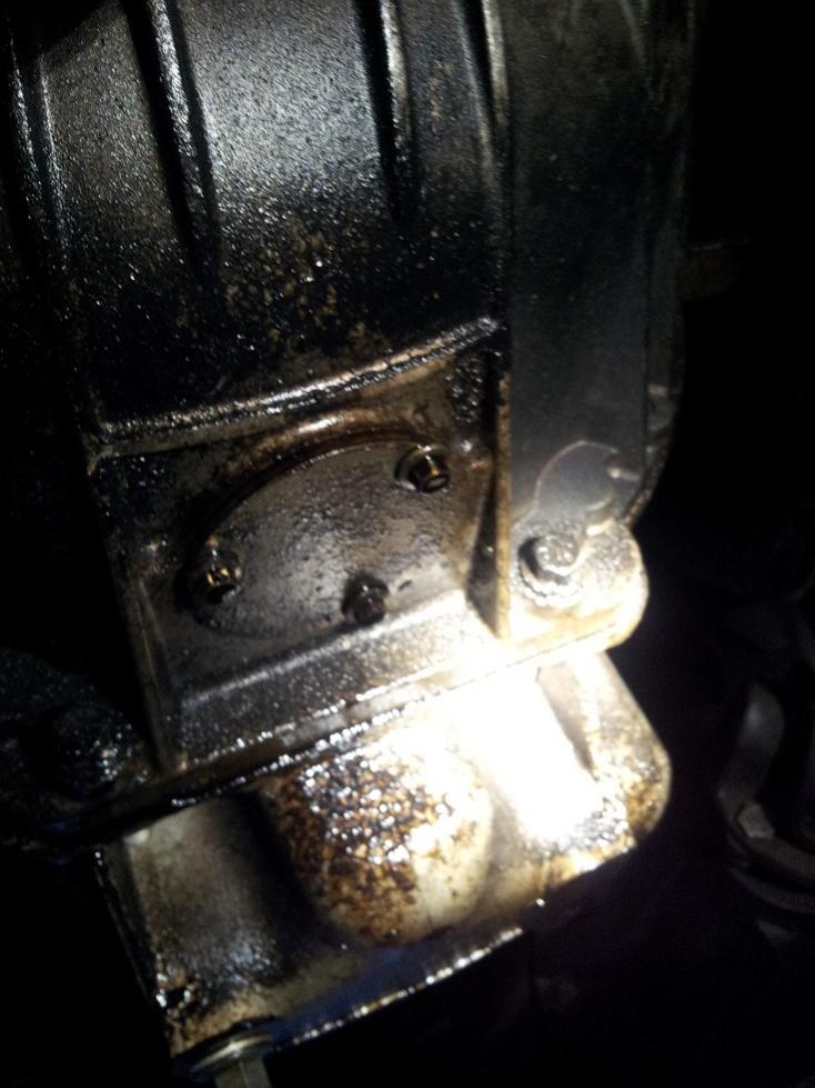

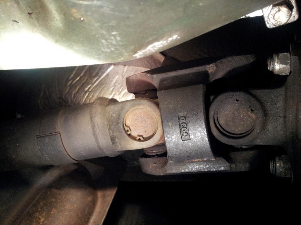

Here are some pics I took today. Can anyone give me some feedback on how my drive shaft looks? I plan to rebuild it next weekend, but will have to wait for the parts to arrive from Atlantic British. Does it make sense to try to get the u- joints locally? Does the drive shaft look safe to drive till then, assuming I can fix the coolant leak Monday.
As for the coolant leak, it looks like it is coming from the heater plate. I will try to get the plate and gasket tomorrow from the dealer along with the line going from the recovery tank to the throttle body. I would like to drive the truck to the dealer so I can get a new key, but need to repair the broken plastic line first. Should a rubber line be okay to last me until I can get one at the dealer or from Atlantic British? I was thinking on using one that that goes from the radiator to the recovery bottle on a Benz parts car I have on hand. Any recommendations are appreciated.

I found a set of 3 new Meyle U- Joints online for $38 delivered and a set of 3 new GKN U-Joints for $67 delivered. Any recommendations on which brand to choose?
