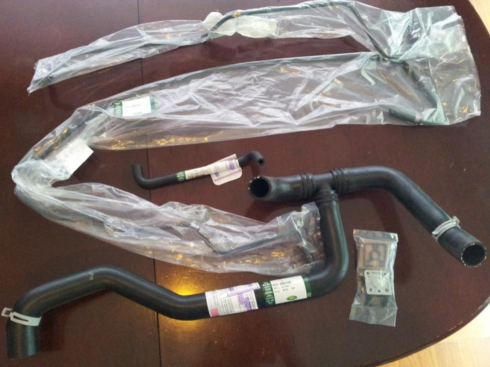

I stopped by the Land Rover dealer today and picked up some hoses and a heater plate to fix my coolant leak and I have to give the staff there credit. The customer service was fabulous and they gave me a 15% discount on my parts for being a Houston Land Rover Club member.
Replacing the small hose that goes from behind the a/c compressor to the throttle body was a major pain. I had to remove the bolts on the a/c compressor to move it and with the surpentine belt on I can't get the bolts started. The belt is pulling the front of the compressor down and I can't figure out how to get the belt off. I know it should have a spring loaded pulley, but I am having no luck getting the pulley to move. To make matters worse, I dropped one of the throttle body bolts and can't find it anywhere. It has to be somewhere hiding down the side of the engine, but I have no idea where.
Here are the parts I am replacing.

Well, everything turned out okay. I figured out how to move the tensioner so that I could get the A/C bolts in and I found the throttle body bolt I dropped. The truck runs great now and I think I have stopped the coolant leak. I did notice that the power steering fluid is bubbling when the engine is on. Is that normal?
