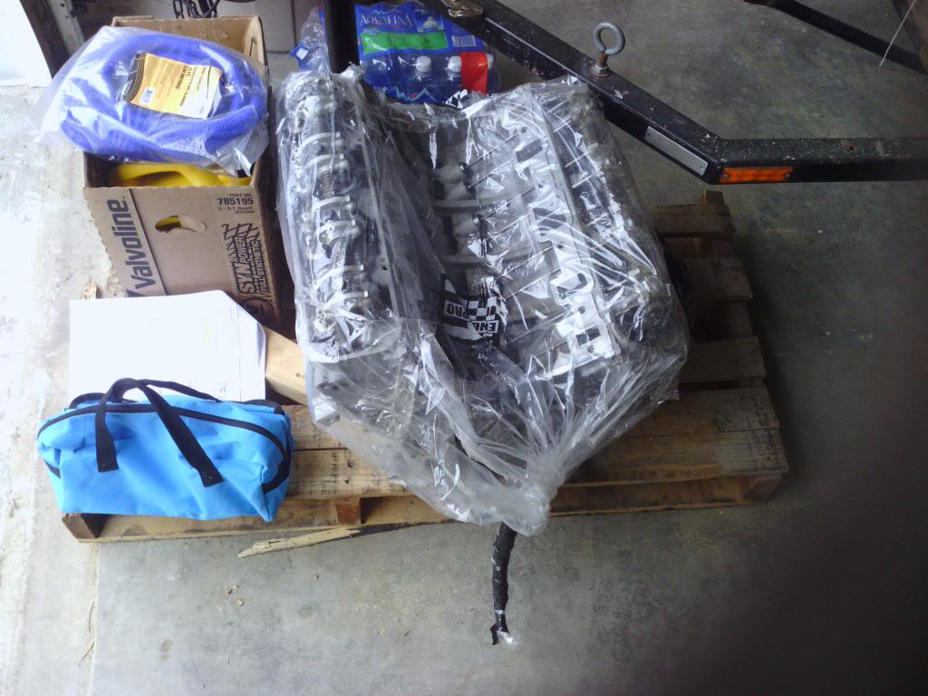

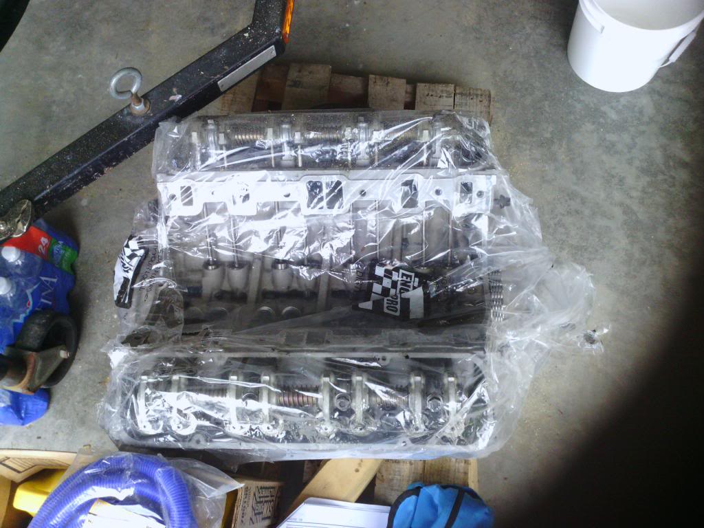

Finally got pics uploaded. Sorry it doesn't look any different than a cleaned up version of the stock motor without the heads off (I bought the long block), so not too exciting to look at.
Pretty much how it arrived.

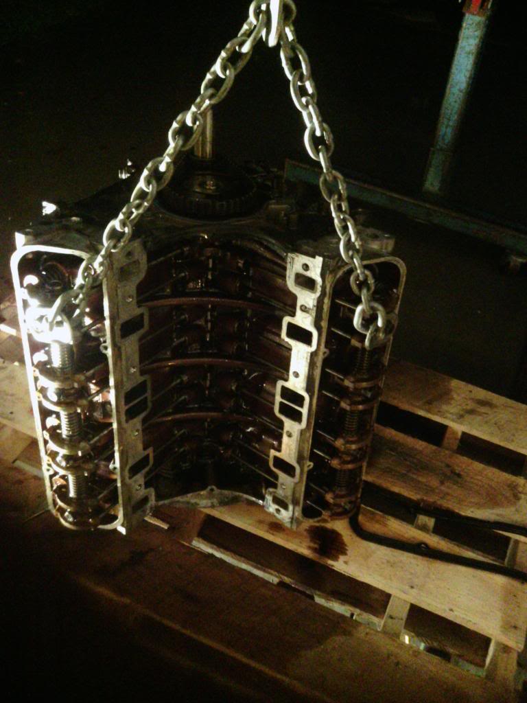

Out she comes...

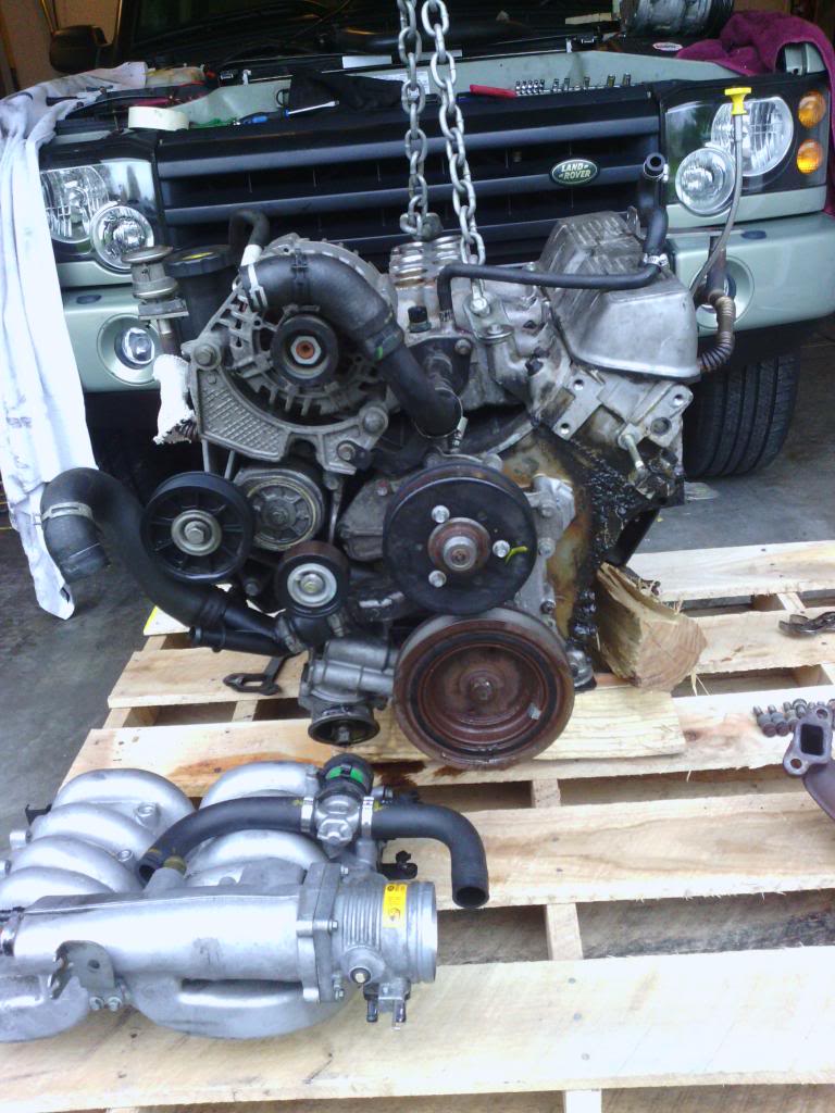

My beautifully bronzed baby!

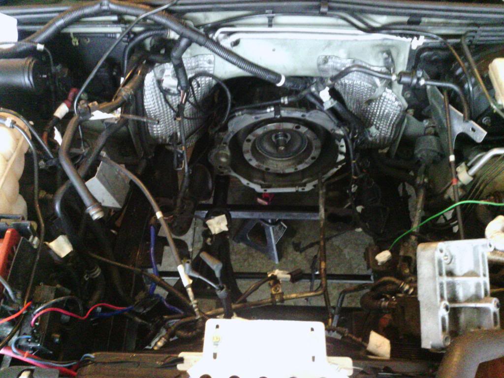

In she went...

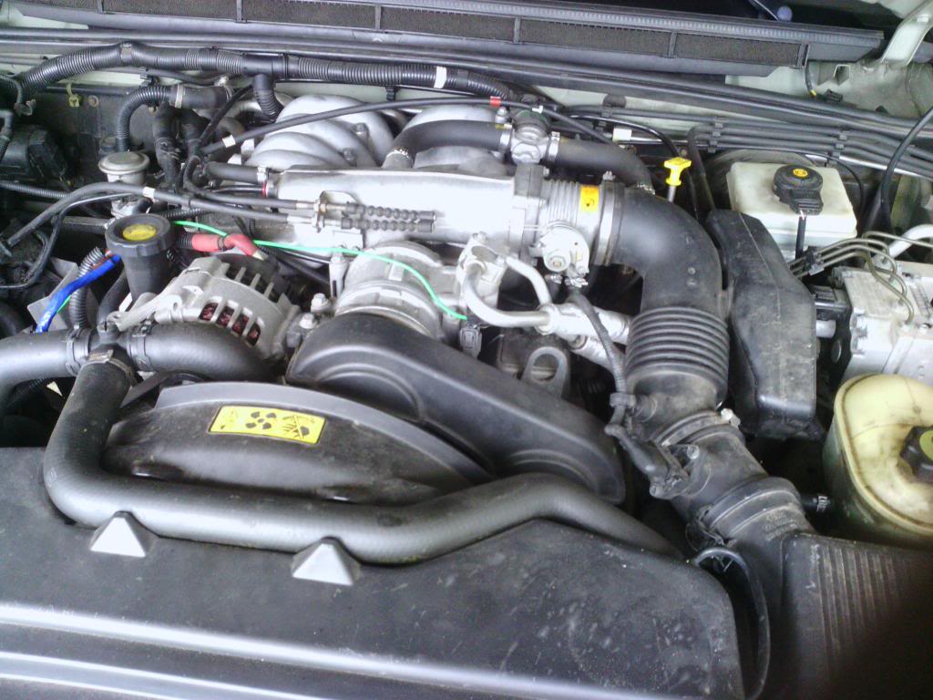

Not too complicated, but you'll need every version of 13 and 10 mm sockets (deep, shallow, 6/12 pt, 1/4, 3,8, 1/2" drive w/extensions), plus 12mm 12-pt socket for the heads and 8mm 12 pt for the Valve Covers. Speaking of, put the VCGs on the VCs first. If you press the lip around the outside, it'll hold while you put them on...too easy. Take copious pictures of wires and hoses...especially if you have SAI. In fact, if you have SAI, sell the truck first, buy one w/o SAI and then start the procedure. Mark your throttle cable settings before you remove them (I had to remove mine to get the upper intake far enough out of the way). Hardest part of the whole thing was the side bolts of the bell housing and top nut of the Dr Side motor mount. Of course on mine, the exhaust studs broke off. Depending on what the shop wants to drill them out, may go with Magnaflow cat-back, which will probably compliment my more aggressive cams well.
