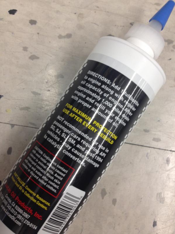

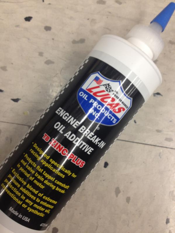

JimmyTomahawk's Avatar
Joined: Oct 2012
Posts: 34
From: Marin County, California
See attached images, what are your thoughts about the cat converter damage that zinc additives are prone to cause? I'm apprehensive to add this stuff to my new GPR engine even though Mike suggests doing so in his warranty agreement.
Attached Thumbnails New GPR Block installed-image-3512926514.jpg   New GPR Block installed-image-700254536.jpg
