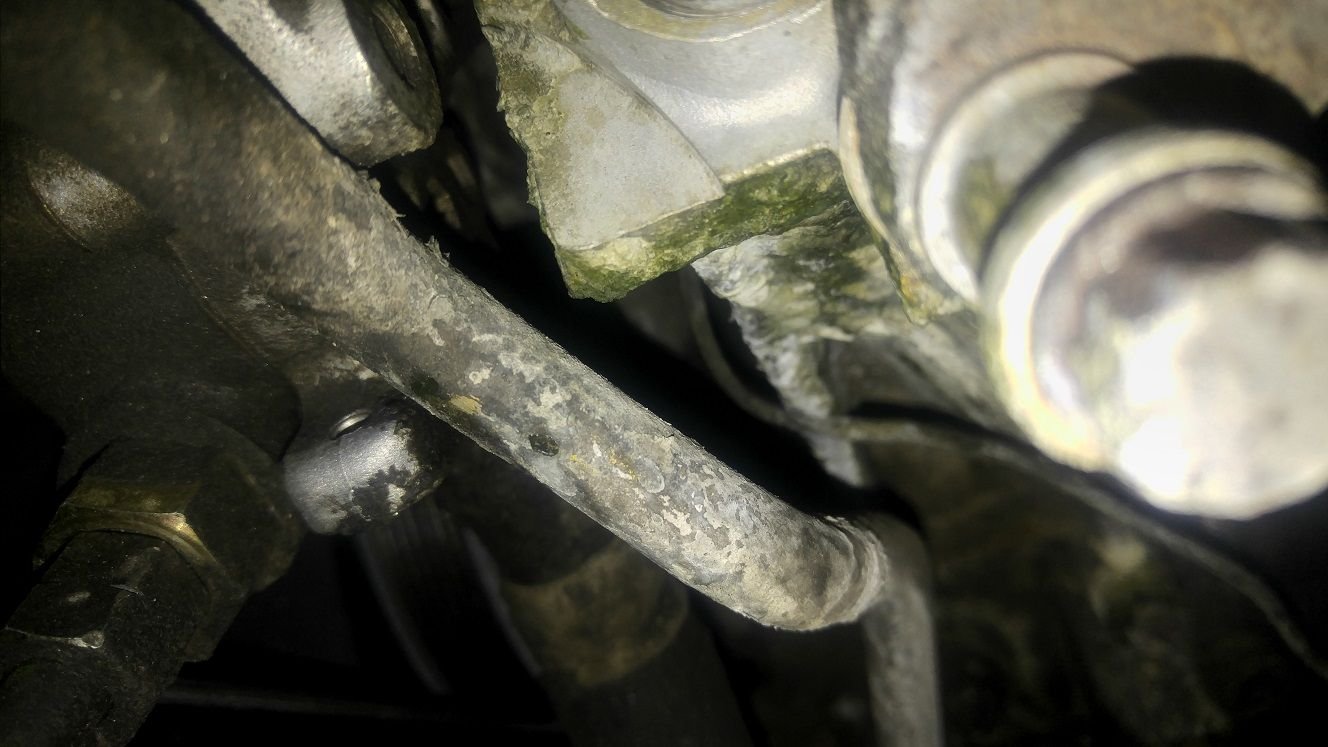

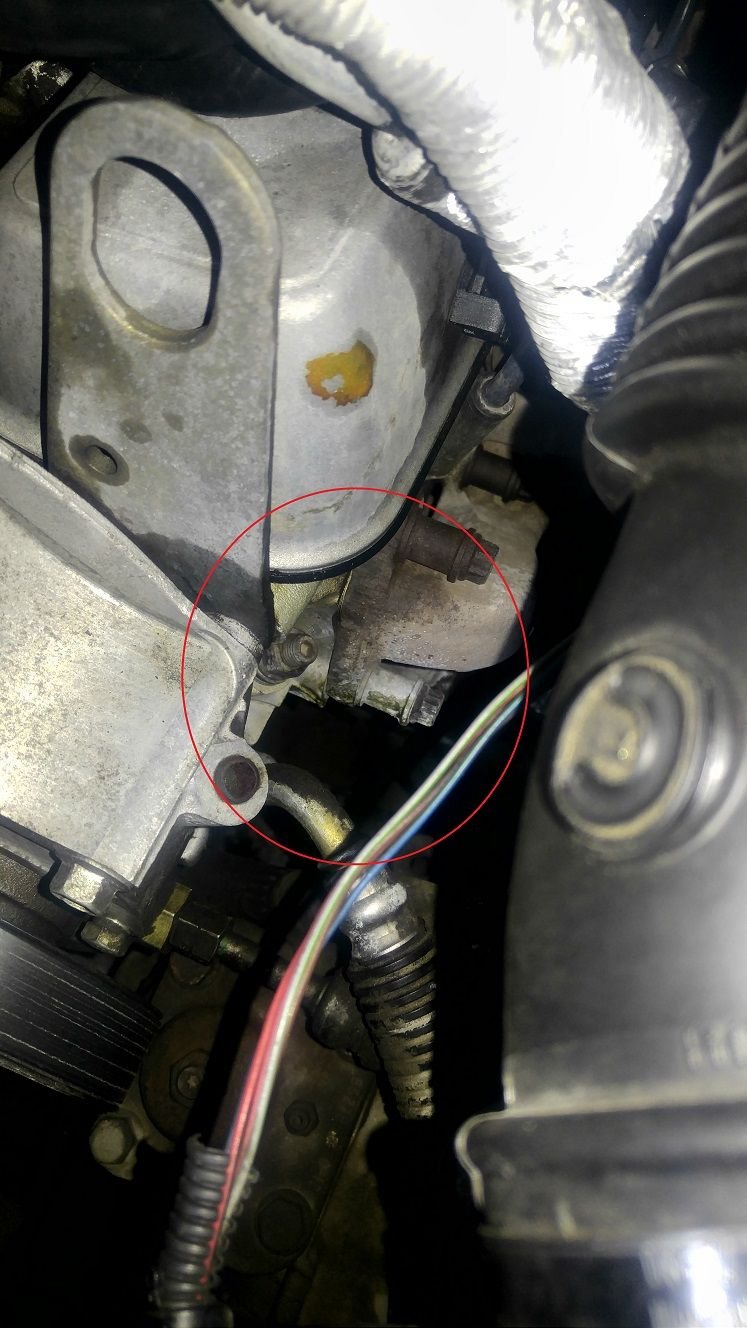

Ok, tried to pick the best couple pictures. It's a tricky spot, drivers side. Coolant is evident on the bolt/stud in the middle of the red circle. Second picture I stuck the camera down in that area and hoped for the best.

Coolant over on that side could be dripping down from a leaking throttle body heater.

Another vote for the throttle body heater and/or the rubber hoses that connect to it. Mine had a similar leak but I was able to fix it with a new piece of rubber hose that connects to the throttle heater.

CPS is under a little silver cover on the lower drivers side of the engine. It could be the stupid throttle body heater plate (I properly bypass all my D2's throttle body heater plates & completely remove it from the throttle body. Or it "could" be a seeping water jacket.
