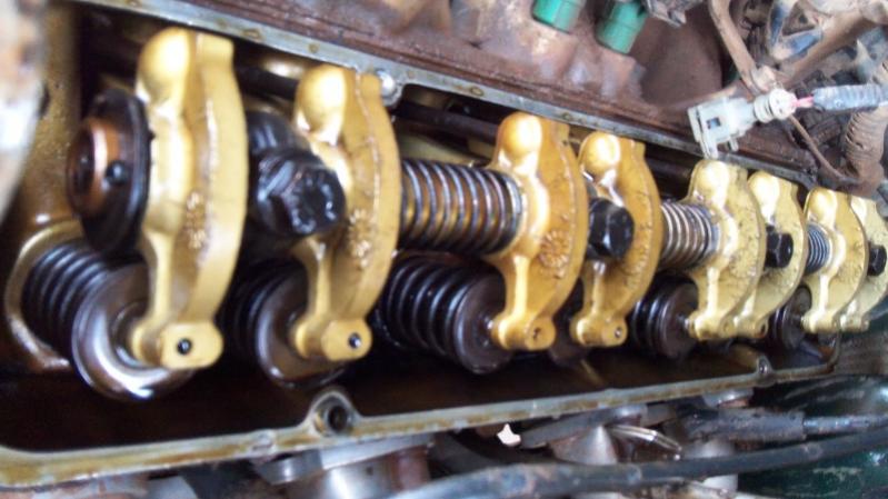

I belong to the bigger oil filter tribe. Spreads the dirt out a little more. But on older Rovers, ravaged by time and lack of money by previous owners, oil galley drains from under valve covers can become gunked up. So the oil is held longer in the valve covers, and eventually the oil pickup in the oil pan is sucking air. So at higher rpms the oil light flickers on (never ever a good sign) because you have dropped below 7 PSI, when you should be 50. Next morning, oil level reads normal. The extra large filter is more "insurance" against this.
Rover used to offer an oil PSI gauge as an option back in the 50's. We are obviuosly too stupid to use such a gauge, but we can operate a sat nav system whilst the ACE keeps us on the roadway during a high speed pedicure run by SWMBO.
As for exact filter, I think I shall switch to the Baldwin, I currently run the Purolator/MANN.
Pix of gunked up head, oil filter, gravity drain galley passage, and a truck with 190K and Castrol/Rotella at reasonable drain intervals.

My heads had no gunk, but man was it a pretty dark bronze color! A local UK vehicle shop suggested Pennzoil because it was the only one with the detergent additives still in it. Up until now, I had no reason not to. Thoughts???
