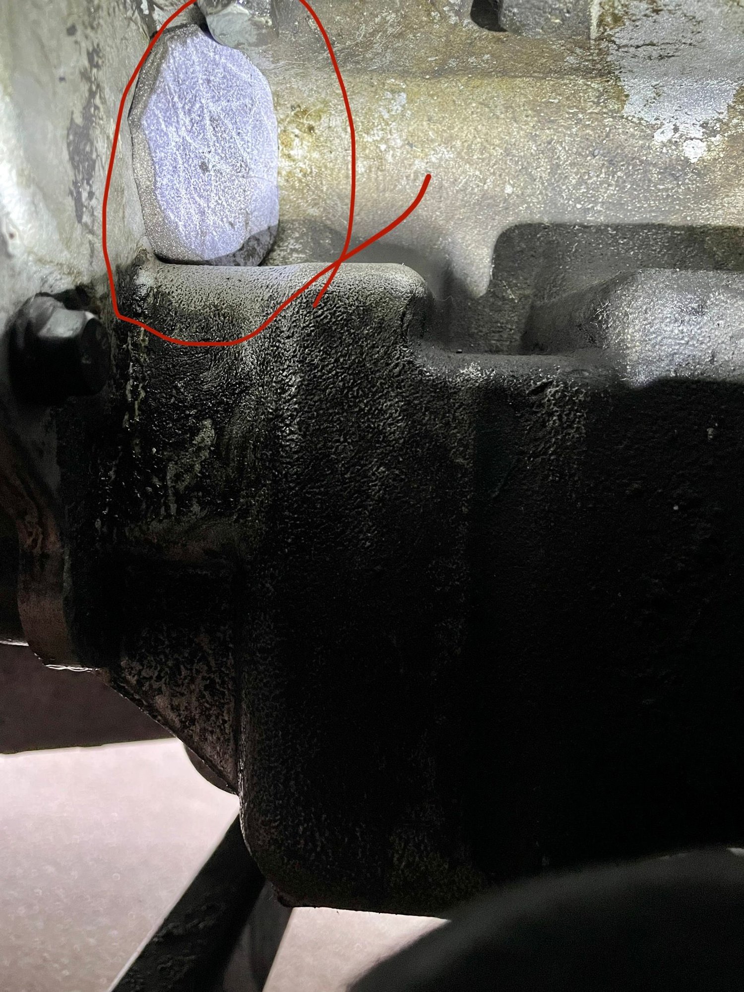

I’m new to Rovers and have a couple of questions. My Disco has an overflow tube on the overflow tank that is letting some antifreeze out each time I drive it, which requires topping off every 3-4 days; is that normal? Also while underneath the truck I noticed a hole on the bel housing on the passenger side the size of a silver dollar. I didn’t think it should be left uncovered as FOD would get in there so I plugged it up with some dense foam temporarily until I learn the correct application. Here is a photo.

2. The hole on your Bell Housing originally had a rubber plug. At the age of our vehicles the rubber has perished and departed. The plug is available. Mines also missing but I haven’t got a new one yet.
