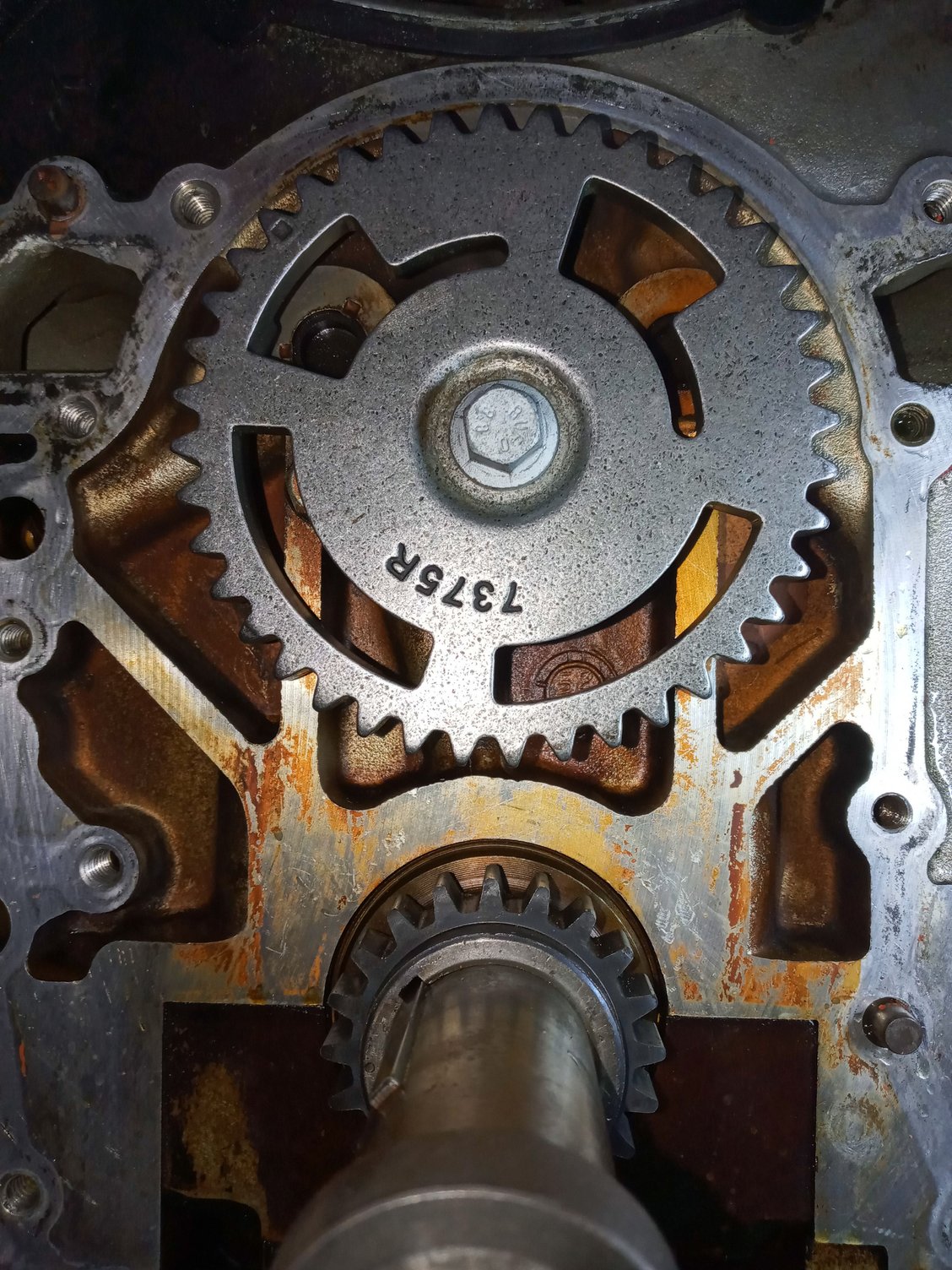

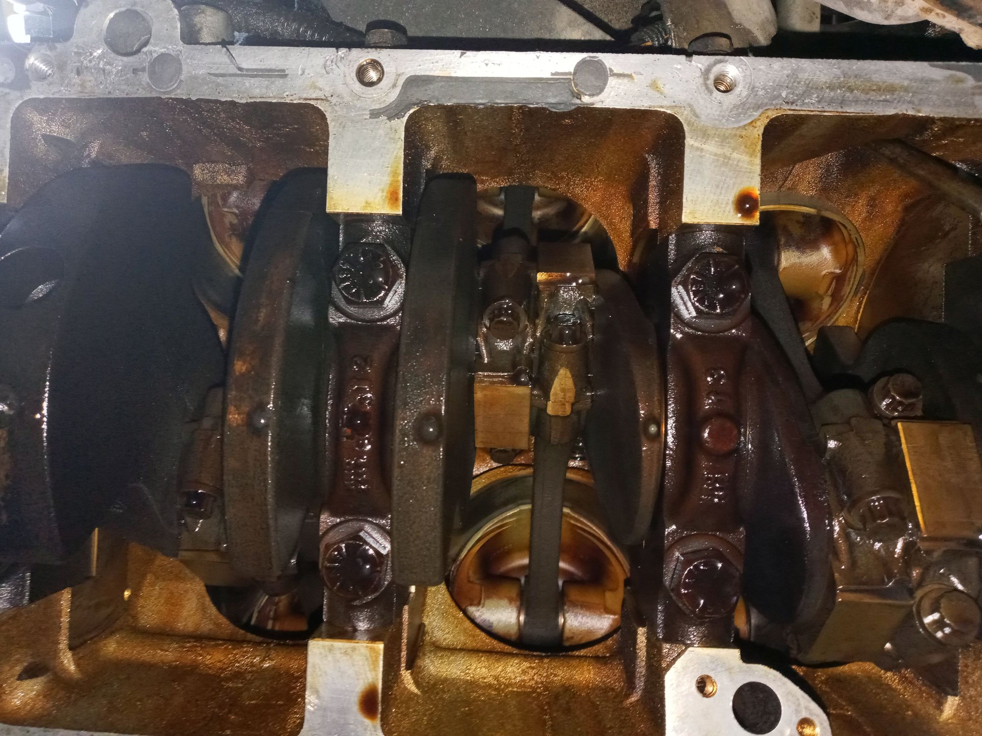

Can you take a few pictures of the timing gears, crank shaft gear especially.

Ill post some pics and videos in the morning. I appreciate all the info because at this point, short of pulling the heads Im stumped...
