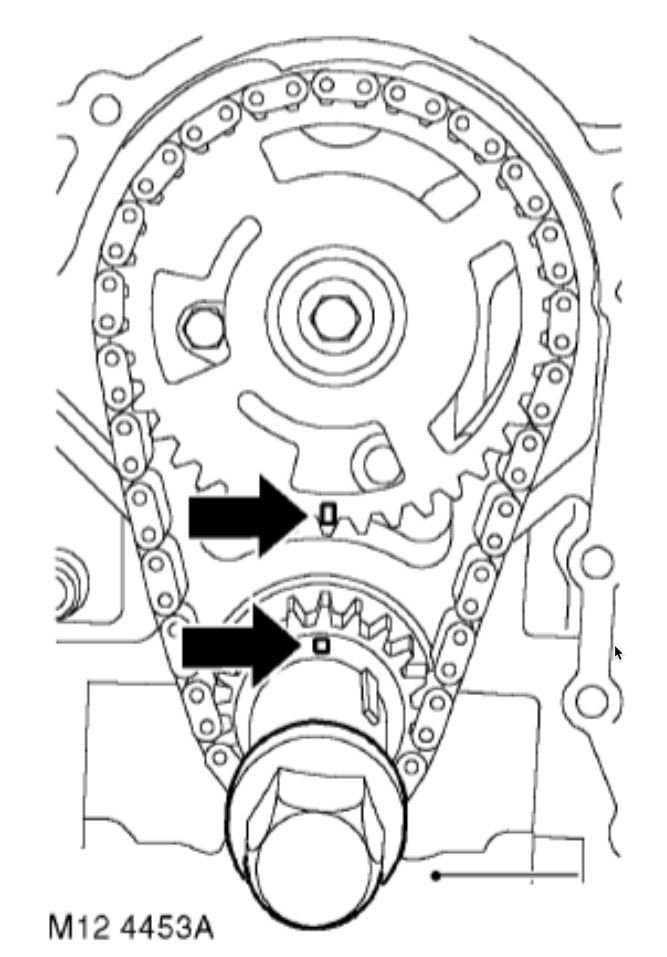

Did you line up the timing chain marks when you reassembled the engine?
I can't seem to find a definitive answer on if this is or isn't an interference engine. IF it IS...and you're rotating the cam without the timing chain in place, I wouldn't expect you to be able to do a full rotation as at some point your valves will hit a piston. Also, IF it IS and you didn't line up the crank and cam gears properly, it would explain why it didn't turn over (Valves hit the piston).

Well...the key question is: Did you line up the timing chain marks when you reassembled the engine? I'd probably try the following first:
  1. Remove valve covers
  2. Remove rocker arms
  3. Align cam and crankshaft gears using the alignment marks, reinstall the timing chain
  4. Reinstall the rocker arms
  5. See if the engine rotates properly using a ratchet or wrench.
