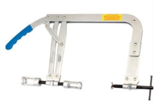

As mentioned, valve grinding is still twisting a piece of dowel while I owned the Gunson power tool and have just ordered one via Amazon UK.
Then valve spring compressors... In the UK I had a forged G clamp style device with a end specifically designed to match the top of the valve and the screw in part levering against the head of the valve. It was very firm and positive.
I bought a $25 version from O'Reilly that supposedly grips the spring as the top part presses on the top of the retainer... scary because the part gripping the spring keeps pinging out as pressure is applied. I will persevere but as I mentioned about the stretchy bolts... there has to be a better way!
I can import this unless they are available out here....

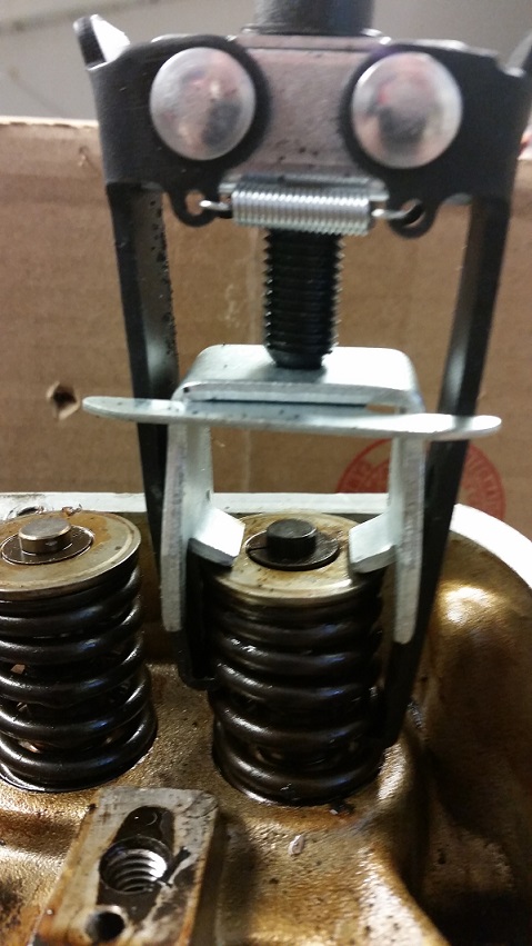

The problem with the version I bought is that the inner section that pushes down the valve retainer also pushes apart the feet gripping the valve spring so it flies off long before enough pressure is applied to press down the retainer...
That is the kind of compressor I have used for 50 years, Sears has them for 50.00

Perfect! Thanks!

I drove to Sears and bought their valve spring compressor tool for $17.94 which is the bargain of the century. It also works extremely well once you set it for the optimal setting for the particular head and is much better then the G clamp style I used in the UK because of the time screwing the thread in and out versus the Sear's quick operating lever principle.

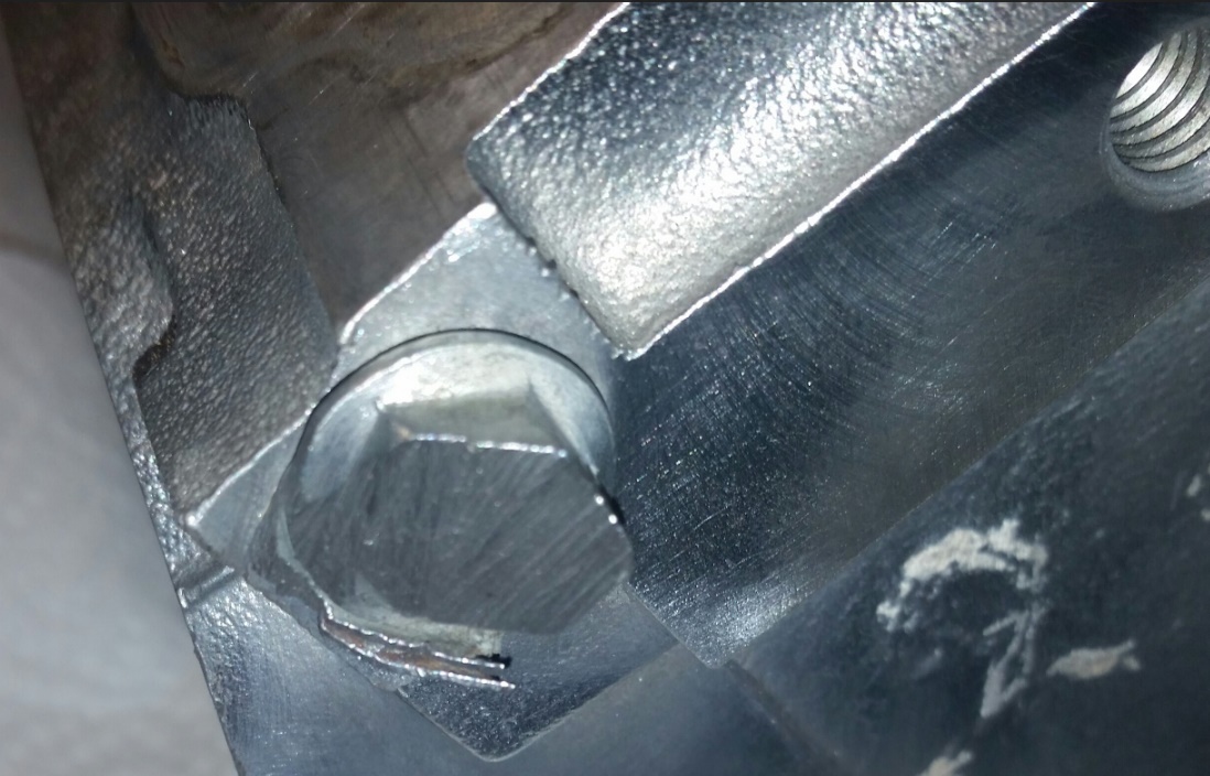

Returning to a prior issue where the wiring loom was a congealed blob on the back of the driver's side cylinder head and I had to hacksaw it off to be able to remove the head...
Well, it was a pig to remove and it was obvious I was cutting through steel rather than pvc and copper and, as you can see from the photo, I did indeed cut through the head of a bolt.
It's a bit mangled but it looks like there was a clip or retainer under the bolt so could someone who has trod this path before, please tell me what the function of this bolt was..???
It can't have been to retain the loom....
