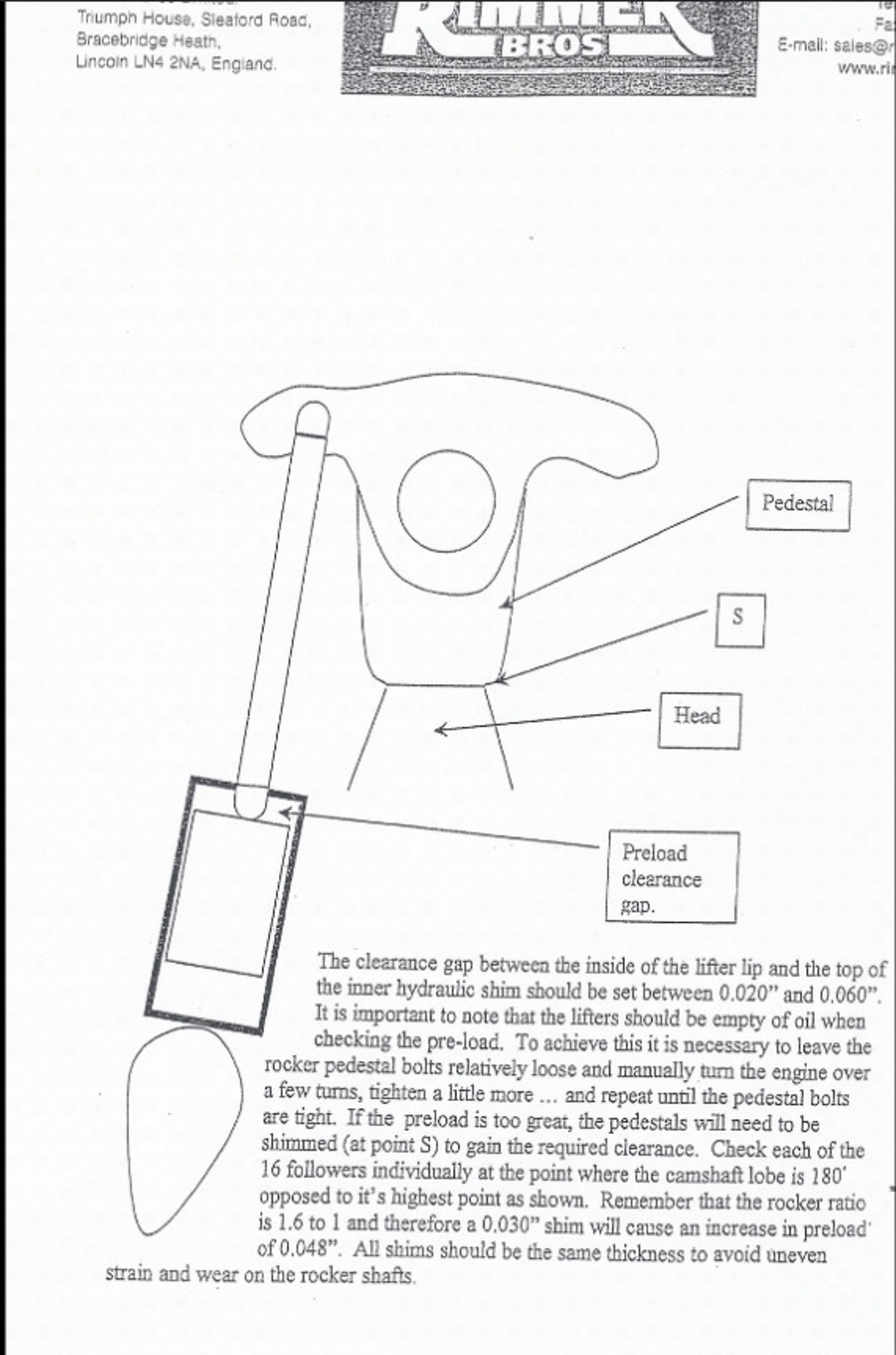

Hi
The reply from Rimmer Brothers came today... a bit of a disappointment as it only shows how to increase the valve clearance rather than decrease it because of wear on both faces of the rockers and within the hydraulic tappets.
I wish I had checked the clearance before I stripped the engine down to get an idea of the float and am loathe to stump up almost $200 on adjustable push rods if I didn't need to.
A right enigma...

how much were the head decked? gives you the measurements in the rave
Hi
I may not get the heads machined as, after cleaning them up, I don't see any damage to the faces from the blown gasket.
I have the downloaded pdf Discovery manual and it just gives the torque value for fitting the rocker shafts... I could not find mention of valve clearance or float and the Rimmer suggestion presumably only applies if you have a substantial amount machined off the face of the head that lowers it and causes the float/clearance to diminish by a similar amount.
If you can find the page I would appreciate a look at it....
I think that when I reassemble it, which won't be for a while now, I will fit the pushrods and rocker shafts and check the clearance at the front and rear valve positions. If it's outside the limit I will have to pull the rocker shafts off and buy the adjustable push rods though my gut feel is I won't need to.
