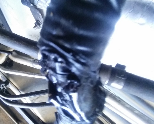

Everyone has different thoughts on head work but I'm from the old school, and am keeping the car, so I want the engine to be better when I put it back together with everything perfectly machined and gas tight.
That said, the car took a back burner with work and family issues taking priority so it was Saturday evening I removed the final couple of screws to remove the driver side cylinder head...
You will recall my comments about finding evidence of shoddy prior repairs, well tonight I found a doozy that is the equivalent in surgery to a heart valve operation...
The previous fixer did not tie back the wiring loom so all this time it was pressed against the rear of the cylinder head and it's a congealed mess that is a bugger to release from the head. Lord knows what it has done to the wiring but it's going to be like surgery to remove it so i can pull the head away....
It's dark now so Sunday I will gently saw through that mess to release the head... then I have to cut open that loom and check the damage to the interior wiring, cutting back and replacing sections as necessary.

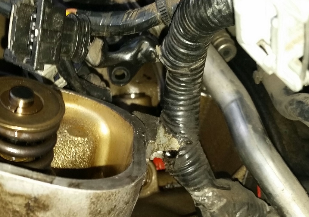

That's a real bummer. There is supposed to be a keeper for your spark plug wires back there but I don't recall anything that specifically holds that part of the harness (where it goes down, by the coils).
On a positive note, your springs and what I can see in the valve cover look awesome to me.

Sunday morning and a new fine tooth hacksaw blade. That was a @#$& to saw through being at the rear of the engine and everything in the way, and I assumed the cylinder heads were identical but it was like I was cutting through steel with that saw, not molten pvc and copper wire, like the head of a bolt. Anyway, later I will cut open this loom and check the damage but in the meantime I have heads to sort out.
