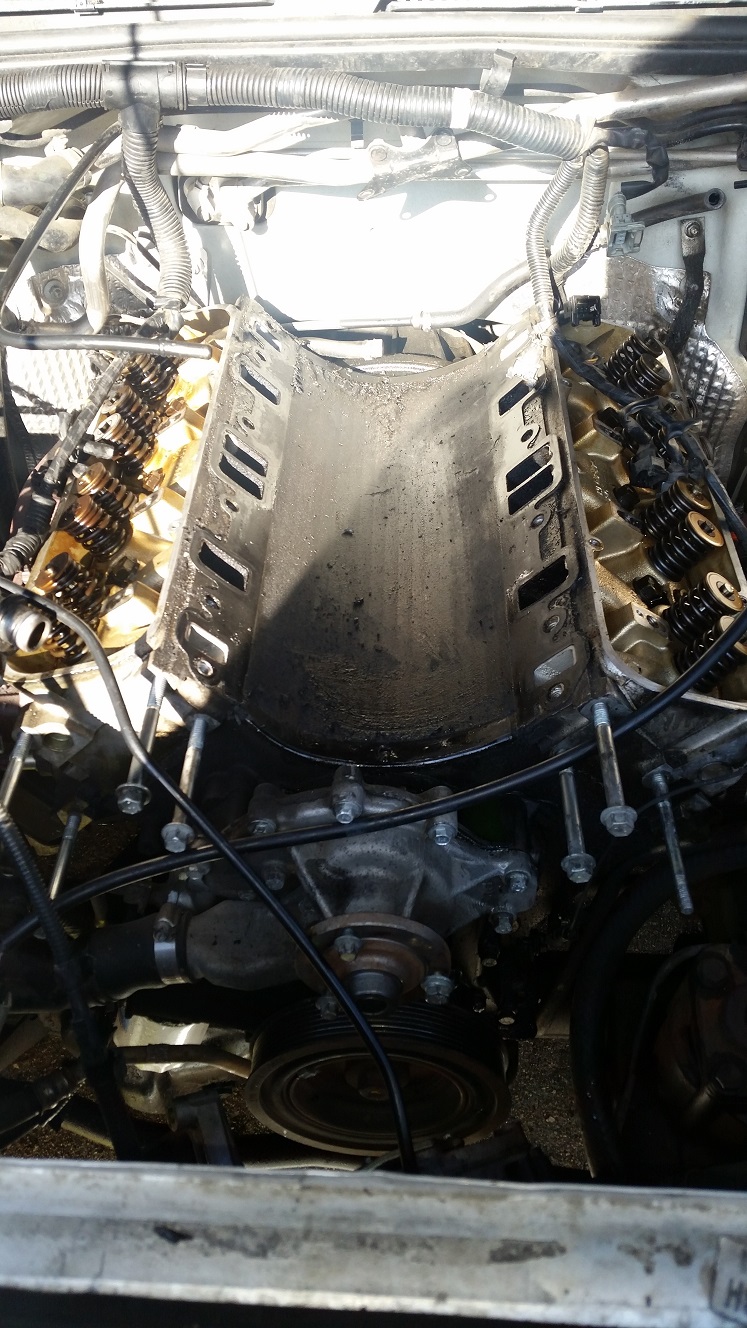

Hi
Murphy's law (I was tired) I took the three screw pulley off (as instructed by the manual) before I saw it was the water pump! I undid screws levering against other screws but the last one was a @#$% to remove.... then I saw I didn't need to....
The PAS pulley I wedged a tommy bar through a hole against the engine and used a bigger bar to release the nut.
I don't know why Rover could not have located the engine a couple of inches further from the bulkhead... that ignition coil pack would be a @#$% to change plug leads where it is. I will certainly change them before I reassemble everything.
I'm English... moved to the USA in 1996... and decades ago when younger and fitter I took a lot of engines to pieces but back then it was 4 cylinders and carburettors and distributors... a lot easier to fix.
But back then I used to use red Hermetite spread really thinly on joints. I gather it's hard to find now and folk are using HYLOTYTE Red 100.... what are opinions on using these?
Also, I noticed Rimmer are selling studs and nuts to replace these stretchy head bolts... what are opinions on this system? I wondered how easy it would be to slide the heads over studs as there's not a lot of room in that engine bay, albeit it does seem a nicer way to torque stuff down...

Please take my advice very carefully.
1) Get a 5/8" BLACK inpact socket for the head bolts.
2) Get a 1/4 inch short extension - 2 inches long.
3) Get an impact grade swivel for the socket
4) Get a 6 inch extension.
Use Craftsman - if you break them they replace them - for the swivel and the extensions
the socket 5/8" must be black impact.
Use 5/8 as it fits very snug.
Never force off exhaust manifold bolts.
You don't need to take the manifolds off the bottom at the Y pipe. Leave that all alone.
Tie the manifolds back.
To put this back on - get a large breaker bar.
Put paint on a stripe on the bolt face to account for the turning 90 degrees and 90 again.
Only use victor Rhienz head gaskets.
Use a shop vac to get ALL water and antifreeze OUT of the head bolt holes.
Don't rush.
Take pictures of EVERYTHING when it is coming apart as here.
You will need those to get it back together.
https://www.flickr.com/photos/76579732@N07/
Old Jul 27, 2015 | 12:43 PM
  #40
jfall's Avatar
Joined: Mar 2012
Posts: 3,171
Likes: 45
Actually to get the bolts off and back on I used a breaker bar and slipped a 4' iron pipe on the breaker bar.
You can buy Iron Gas pipe at the hardware store to slip over the breaker bar.
That works good.
