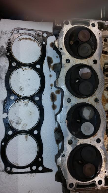

Lord, that back one was a @#$% to get out, working on my own it took a couple of hours of struggling before it gave way. I have attached a photo of the head and the blown gasket... I need to check head and block for signs of damage from the escaping combustion.

Clearly, blown gasket on 3. Have you found a reputable local shop to machine the heads?
Keep at it. You're doing a great job.

The gasket looks terrible but the head looks better than I would expect from that gasket.
