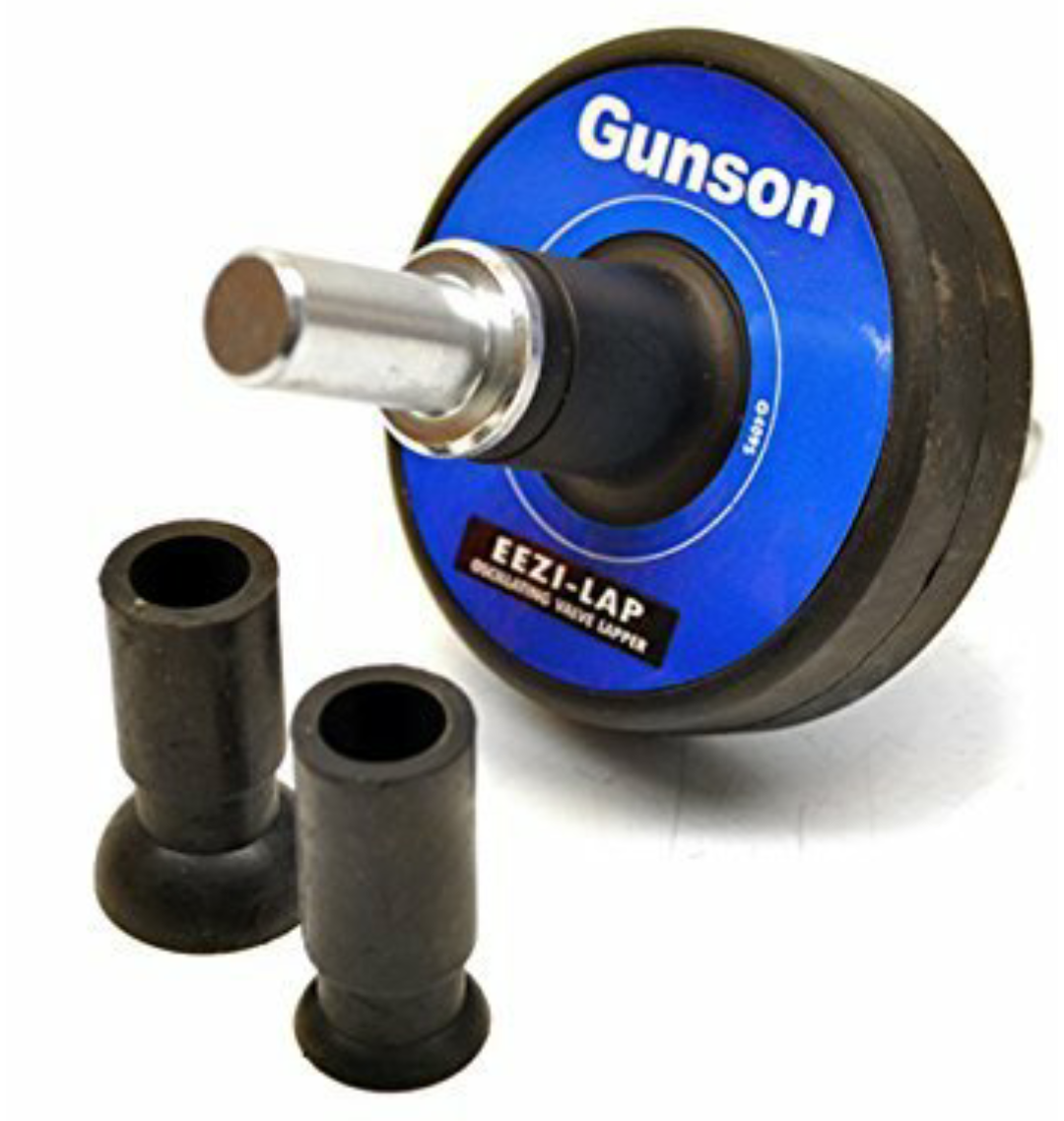

The irony is I can use a wooden dowel with rubber sucker that I can buy in the usa and is what my father and I used 50 years ago in the uk, or I can sign on to Amazon UK or EBay and import a device I used 40 years ago that fits in an electric drill and has an epicyclic internal gearing that slowly auto reverses and would spare me a lot of blisters!
Basically you clean the top of the valve and use coarse grinding paste at first and finish with fine.
You look at the valve seat and the back of the valve for minor imperfections and should finish up with a smooth grey unblemished finish on both.
Of course, you can't make a silk purse out of a sow's ear so you have to decide at the beginning if the seat and/or valve are too far gone and need replacing. But generally you can grind them as I describe.

I admire your tenacity and realize that you have a lot of experience doing these tasks... But, I really think you should pony up the $200 and get a machine shop to do the heads.
I would hate for you to button the whole thing up to find that there is an issue with the valves or the heads were warped and didn't seat properly.

But there are two issues there:-
The integrity of the head.... whether it's warped or flat....
And the state of the valves and their seating.
I will certainly have the first checked but the second will perfectly match each valve precisely to its seating.

In auto mechanics, some years ago, we would fill the combustion chamber with oil and pressurize the intake and exhaust ports and see if it bubbles. We would do this even after a valve job, to see if they needed more lapping with compound.

In the murky past, I have seen exhaust valves so badly burnt they were almost D shaped. While I don't expect yours would be that worn the valves and seats should be checked for leaks and pitting.
It was always drummed into me to have those valves perfectly mated to the seating. I don't personally believe a new valve in a new seating would be as gas tight as one that was lapped in.
