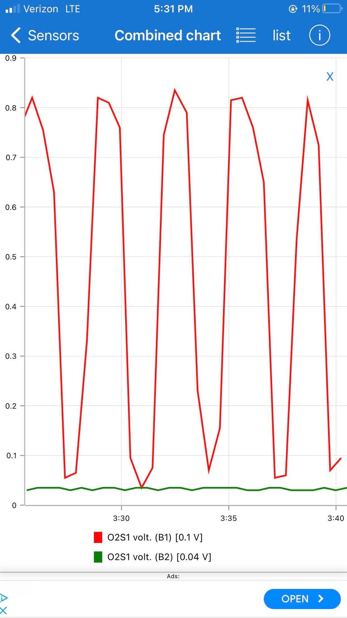

Normally the graph looks like this

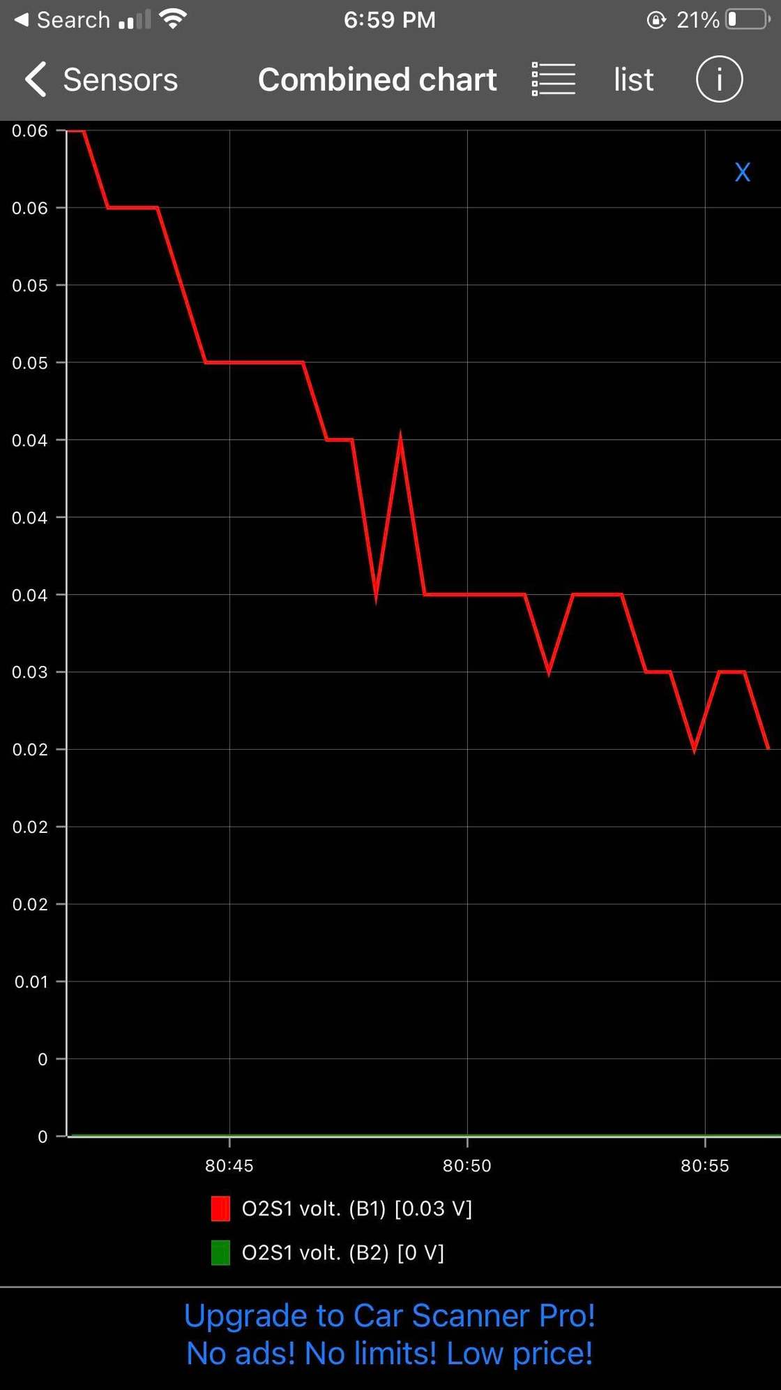

After putting dielectric grease on the connectors it looked like this. Very low voltage for both.

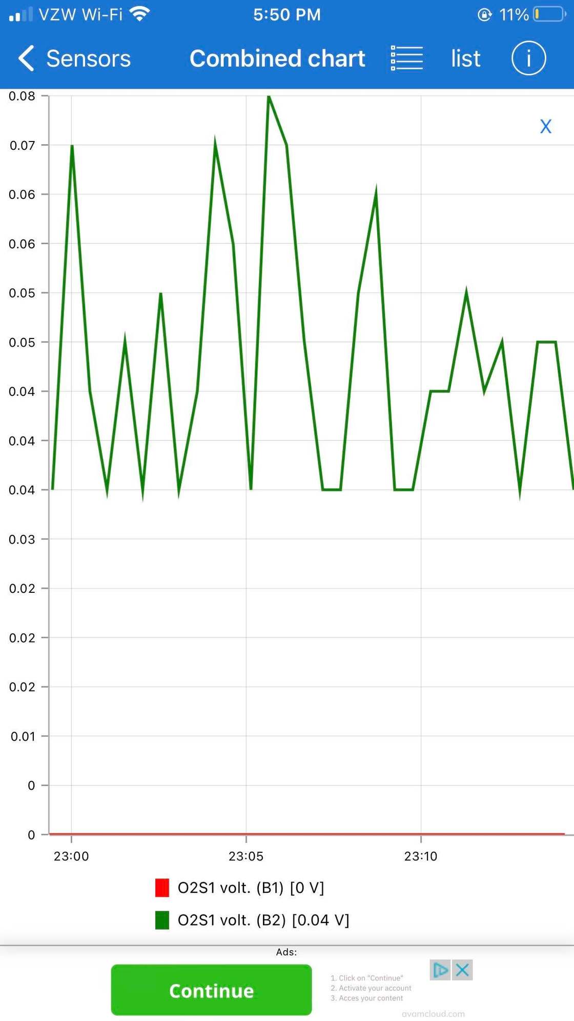

I cleaned the connectors with electrical contact cleaner spray, took them apart a little and the pins were fine. After putting it back together, it was like this with Bank 2 giving normal readings.

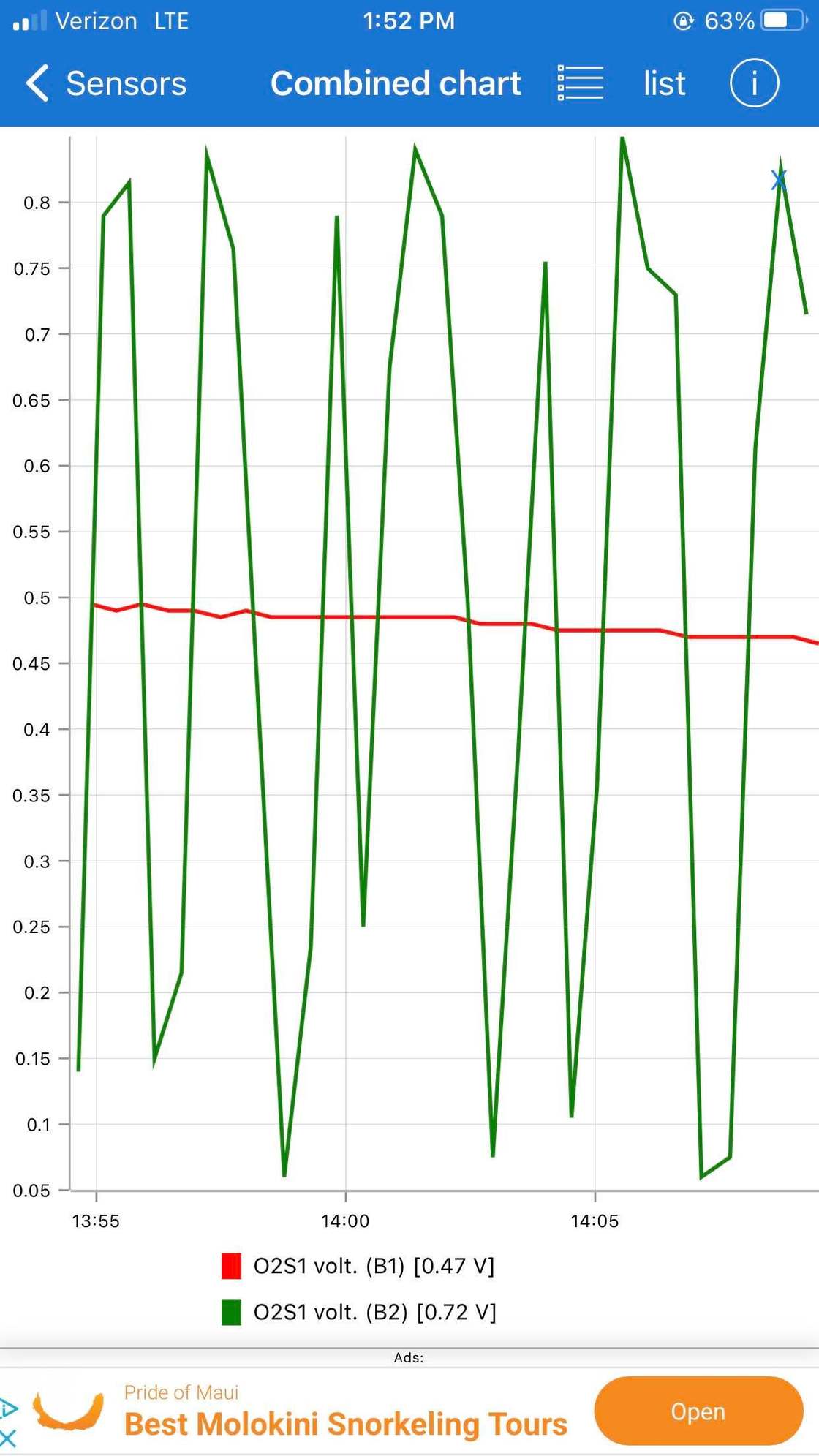

I swapped out bank 1 oxygen sensor with one that was working, and it shows that bank 1 was working with bank 2 now not working.

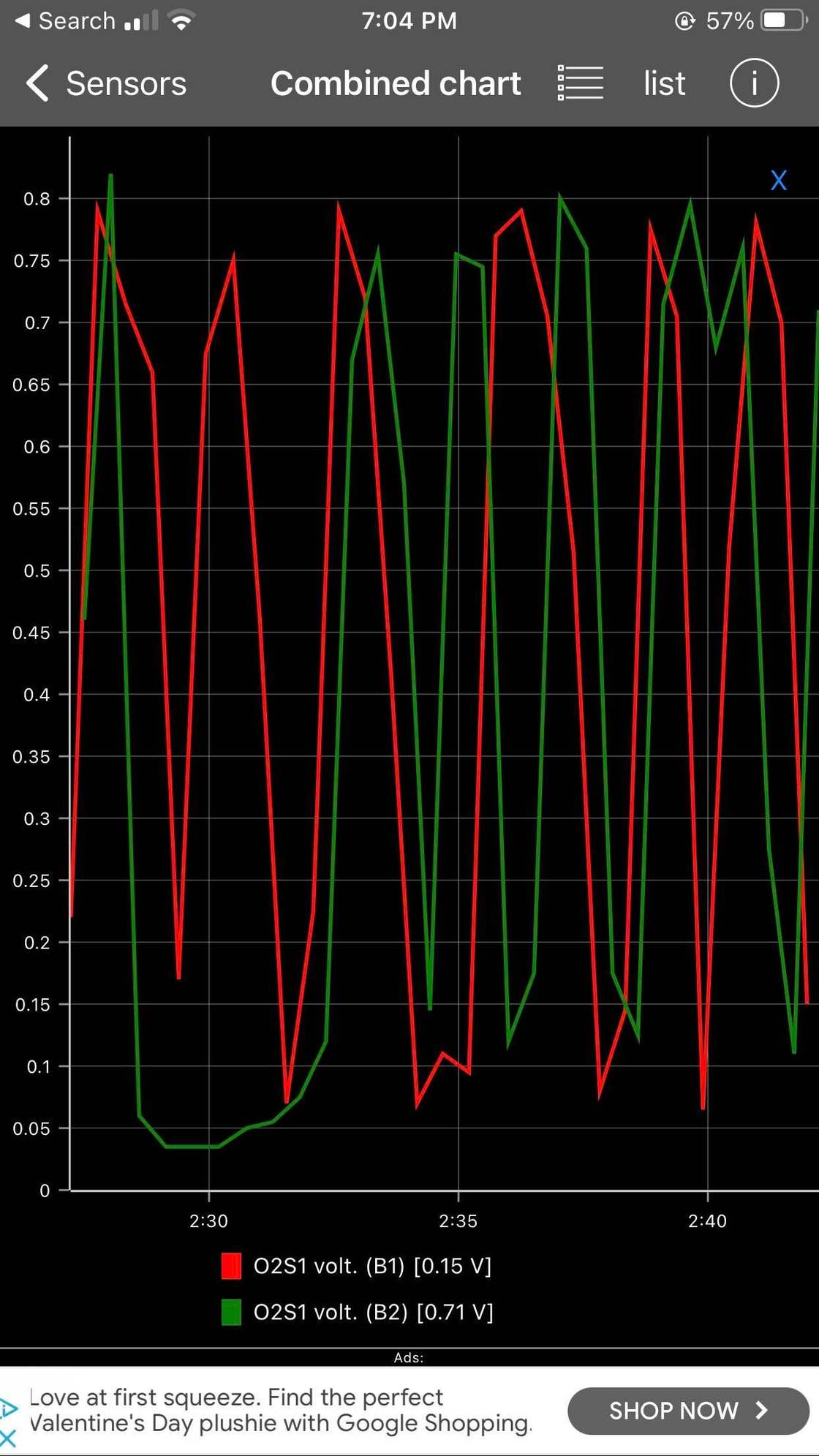

After a little while it started looking like this with both banks giving low voltage.
