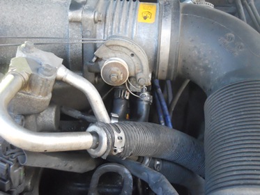

I have little knowledge with vehicles. I've attached two pictures of a coolant leak I have. You can see the coolant spraying out just above the hose. It's almost like it is coming out of the metal housing above it.
Is this an easy leak for me to repair????

Try replacing those two clamps with the screw-type clamps - see if that helps?

This is a very common failure. It is a DIY repair and fairly simple. If you haven't already, replace the Dexcool antifreeze with a universal formula after the repair.

Yup,
Standard maintenance item. Nothing to be concerned about. Buy the kit and replace it.

It is common, not hard to replace with a new kit from the dealer. Make sure you do it quickly before your coolant gets to low and you over heat your engine.

Thanks everyone. Ordering the part on Monday. How long will it take me to replace / remove the other one etc? What tools will I need? Will removing the old one make me lose all my coolant and I'll need to refill?
Sorry for the basic questions.

Bes ure you keep topping up radiator coolant jug until parts arrive, or don't drive truck.
If you have not replaced coolant in last six months: drain, flush, repair, refill. Use a green or yellow coolant. DO NOT USE DEXCOOL.

Depends on you and your mechanical skill, cane take from 45 minutes till you get it done, but it is not a hard job. Be careful when removing the large plastic air intake hose, they get brittle and can break. Make sure to clean out the t/body with carb spray for a better idle.
