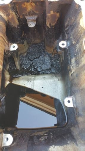

Finally, this is what I found in my oil pan:
Discovery oil pan

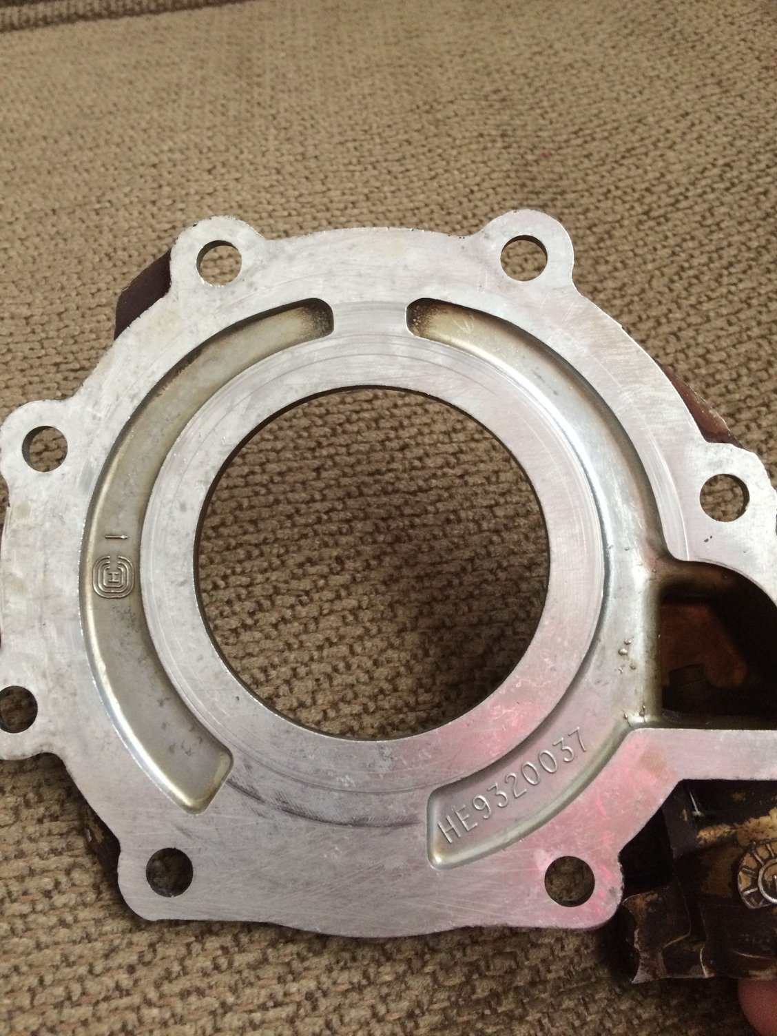

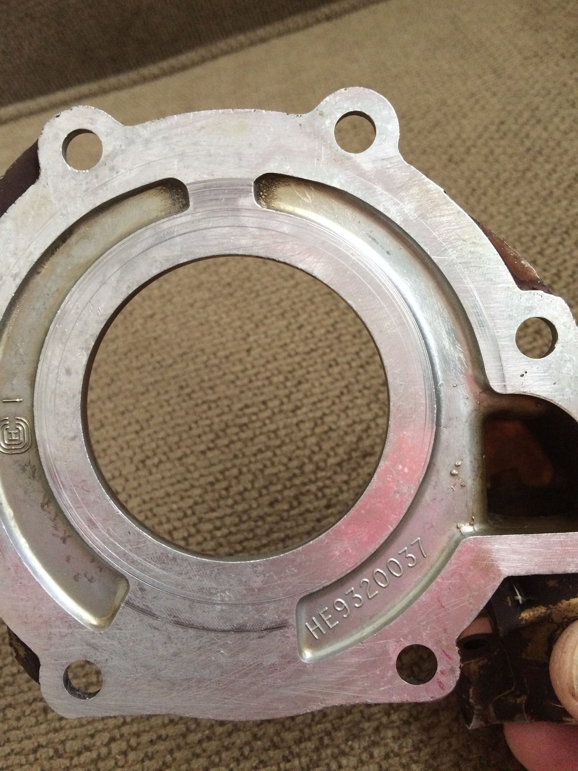

I am prepping a spare Front Timing Cover to be swapped over into my 04 D2. I got it from a 4.0L V8 that had a flickering oil light many many many years ago. I removed the oil pump cover and sure enough the outer oil pump gear has one crack thru it. No massive gouges in the Timing Cover or the oil pump cover plate. It has some small circular marks on it, but no deep groves, chunks missing, or rough spots. I'm planning on just packing it full of Vaseline, slapping in the new oil pump parts, and installing it onto my 04 D2.
