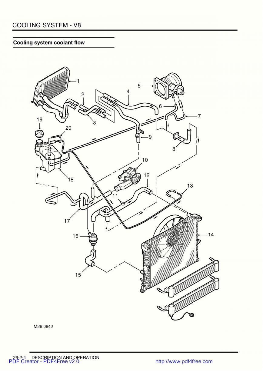

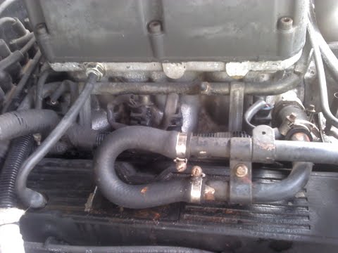

texanaskitchen -
You'll want to do something about the heater core leaking. Here's the plumbing plan for the D2. As mentioned, bypass with a loop until time and money allow repairs.
Understand that your temp gauge is not telling you the whole truth. It will point at 50% from about 130-240F. So use a scanner, ultra gauge, etc. to see real coolant temps. You risk a head gasket job or worse if you run around at 227 while the gauge tells you everything is OK. Note these two trucks, same reading, different temps.
