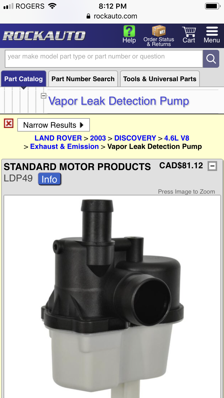

bottom port of charcoal canister goes into the vapour leak detection pump and out of the pump into engine bay into a filter housing on passenger side , I think it’s called the charcoal canister vent line
key here is this vapour leak detection pump is normally open , so air is venting always
ok so from my understanding when the system does it’s check it closes this vapour leak detection pump opens the purge valve and system goes into vaccum.

Vapour leak detection pump
