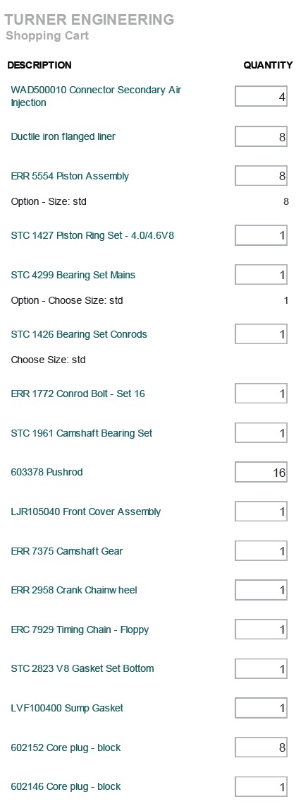

Yes, I have the cam, lifters, and head-studs in the garage on my workbench. I had the machine shop do the block and fit the new pistons, it was the only way he would even agree to do the work- refused to put used pistons in a rebuilt block! I respected that and the price was right from Turner. Same guy did the heads and rockers, said I was fine there and they were in good shape. My truck has 103k on it prior to the build, and I rebuilt my original block/heads rather than doing a core exchange. Stick with the devil you know, right?
Aside from the Crower cam & lifters and the ARP studs, this was my parts-list from Turner:
