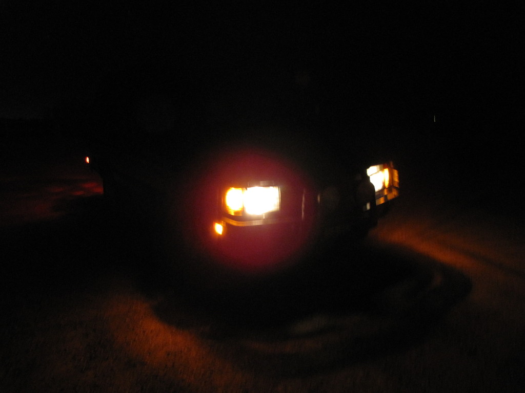

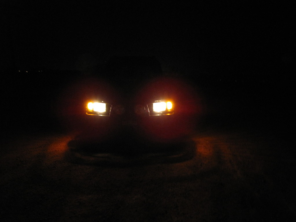

After procrastinating for a couple weeks with the parts sitting on my shelf, I finally got around to converting my front turn signals to marker lights/turn signals. Took all of about 15 minutes once I quit worrying about making the wiring pretty and just did it. The pics aren't the best but I think they're good enough to get the idea across.

Pics of how you did it? I have some spare markers I was going to practice with.

I will try to get some pics of the wiring. Ordered the socket and pigtail for a P38 Range Rover from AB. Turn signal was simple splicing pig tail to original wiring. For the marker I ran the third wire down to the marker in the bumper and tapped the power wire. Pretty simple actually.
Part numbers:
http://www.roverparts.com/Parts/XBP100190.cfm - Dual filament socket
http://www.roverparts.com/Parts/8959ABP.cfm - Pigtail/plug
Bulb is a standard 7528 available cheap at any auto part store.

Thats all i needed. I got clear markers and wanted to do this next but wasnt sure what would fit. Good tip thanks
