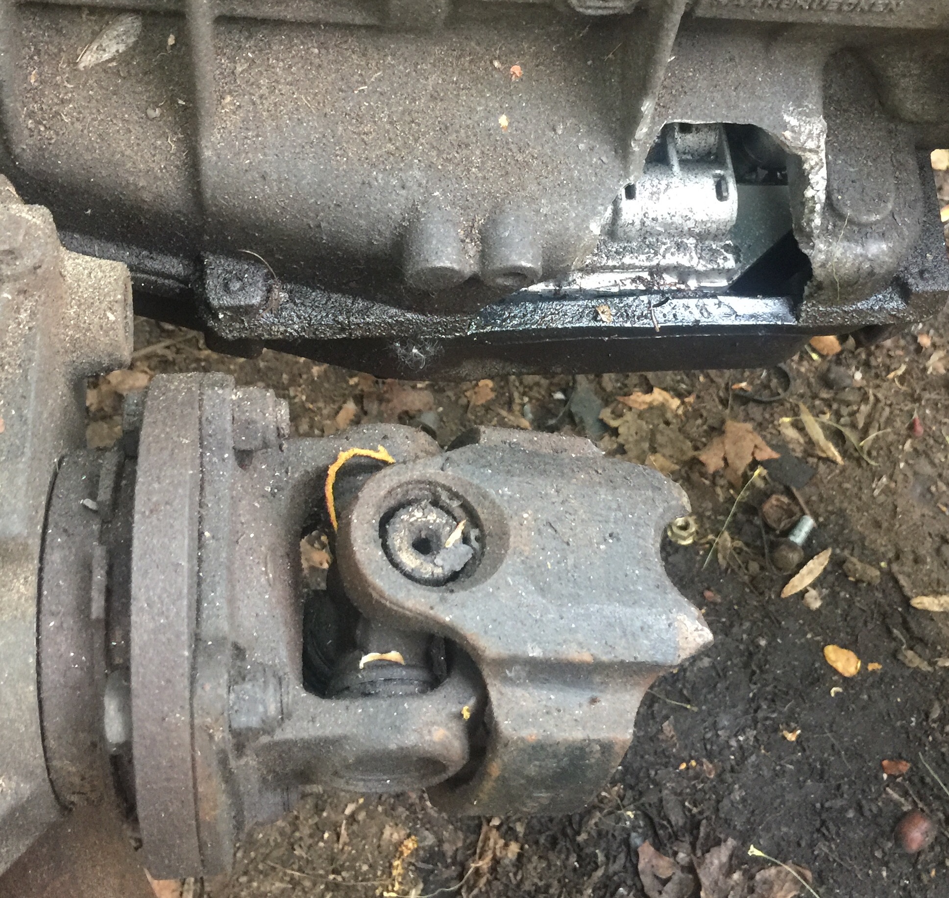

Not looking good. Figure it out before this ends up as the result....

UPDATE! First, I think that I may an idiot and entirely at fault.
I took out my prop shaft today, and the u joints are all solid, but my centering ball is toast.
I had looked up my propshaft order when I started this ordeal, and I remember the description of '5 grease fittings'. I looked the shaft over and only found 4, but found something on the centering ball that is apparently a grease fitting that I completely overlooked.
