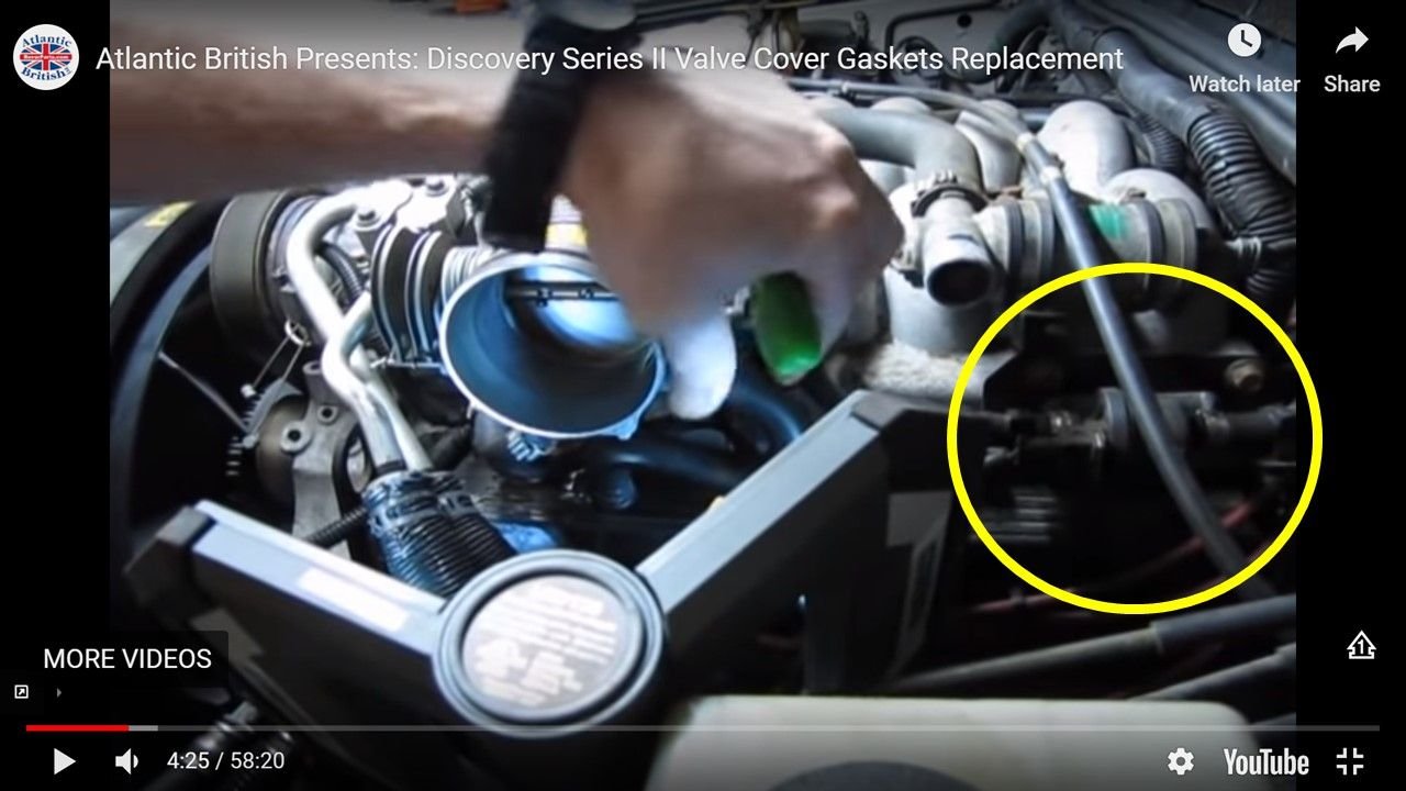

I watched this video before I went to replace it. I have a 2001 Discovery II, it is not located where shown in this video.

It's located on the driver's side valve cover on both my 1999 and 2003 D2s. I don't know where else it could be because the electrical connection isn't really long enough for it to be placed anywhere else.

Will you take a picture please? Is it inside a canister?

It looks exactly the same as in that video. It clips into a metal bracket that is bolted to the valve cover.
Not sure that I can get out to take a photo but you can see the assembly starting at about 4:10 in this video:

Here ya go.... see circled pic
