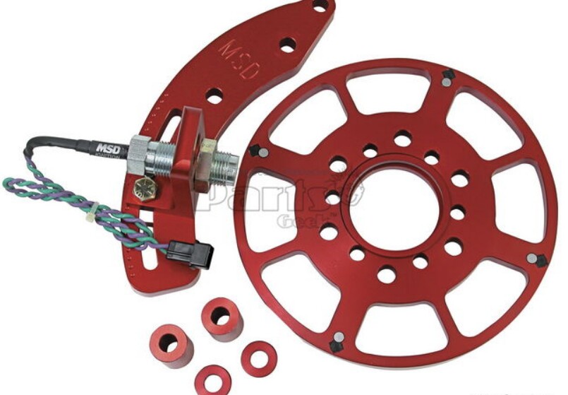

I was asked privately what I was going to do about the crank sensor since I'm using the Rovers Ignition and Fuel System.
Chevy didn't use crank sensors on the series engine I'm using until 96 and since mine is a 95 it doesn't have one.
The Rover uses a magnetic sensor which runs through the back of the engine and uses a magnetic rod which runs into a groove in the flywheel. At a point in the flywheel where there is no magnetic contact, that's where I assume the ignition gets its signal.
I plan to achieve the issue by providing the Chevy engine with its own crank sensor (called a crank trigger) mounted on the front of the engine and tied into the Rovers electrical system (see photo).

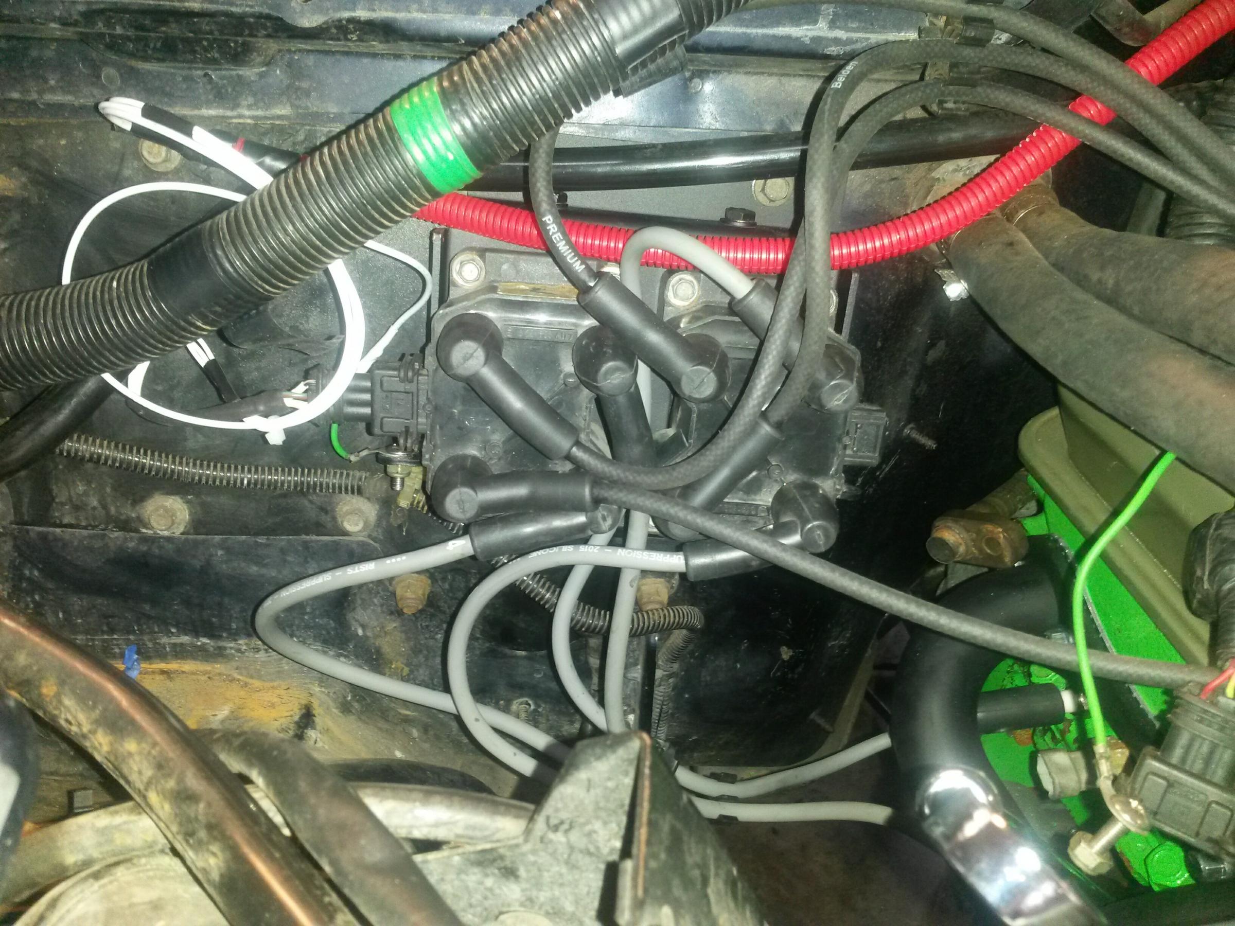

As a matter of fact yes.
I think I mentioned before I live in Florida for 6 mths and Wisconsin in the summer months.
I went up a couple of weeks ago and installed the new motor mounts, ran the fuel lines including the return, made up and installed new plug wires, installed the exhaust manifolds and a few odds and ends including the starter wiring, etc.
Next week I will be going north for the summer and the next step is to connect the exhaust system up, connect the O2 sensors and fill the trans and engine with oil.
Then I will deal with the crank sensor which I will use the crank trigger. Once I run it then I have to deal with the cooling system, charging, pumps, etc which should take a few weeks of my spare time. I will continue to include pictures and any special problems but it all seems doable.
