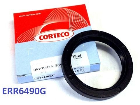

If they won't pay for the tow, and you won't tow it in ... IMHO I'd just fix it. If you do get a proper CORTECO Crankshaft Seal #ERR6490G > https://www.lucky8llc.com/products/f...seal-corteco-4
