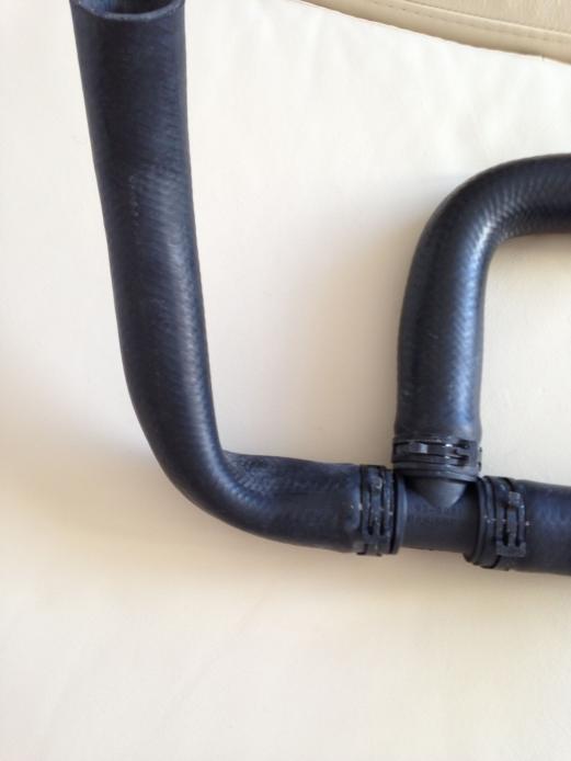

I would recommend OE hoses. Aftermarket top hose from RoversNorth looked like that. They said, if will come up under pressure, but I didn't take my chances, so I've sent it back, wasting shipping charges both ways, which run to the price difference with OE hose, bought from AB.
