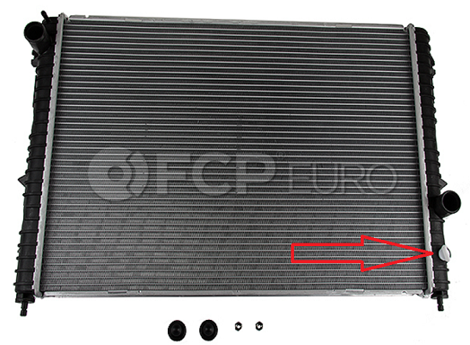

I'm replacing my radiator next week and looking to order parts now. My truck doesn't have secondary air.
Can I use a radiator designed for secondary air, or are they just totally incompatible? I ask because there is a Nissens unit available on FCP Euro for a very low price but it's w/secondary air. I've had great luck with Nissens parts on my Mercedes so I trust the brand and it would be great if I could buy this.
If not I'll have to spend more, but I just want to make sure I get the right part.

SAI radiators will work no problem. It should come with a plug/cap in the spot where the SAI equipped D2 would have a temp sensor. So just leave the plug in place on your non SAI D2 and you'll be good to go.
+1
You can see the plug in the pic, just be sure it's tight before you install.
And WOW that is a great price for a NISSENS Rad from FCPEuro.com >>> $148.15 shipped!!!!!
