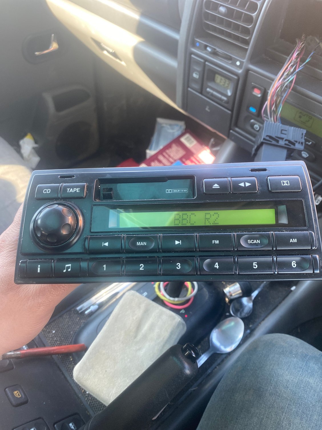

Hi.
I have a 2002 discovery 2 that came with the factory standard cassette radio 22dc597/60-L. I recently bought a Land Rover alpine radio Xqd000110puy. Naively I thought that it would be an easy swap as these are both discovery factory fitted radios.
the idea behind changing the radio was so that I could use a Grom audio Bluetooth adapter to get hands free in the car.
I quickly found that the wiring harnesses were different, so I bought an adapter of the internet. The issue I have is the radio all works correctly but the output volume is very low. I assume this is an amplifier issue. Does my disco have an amplifier?
Any help would be great received as I am stumped.
p.s the steering wheel controls now don’t work either which is annoying.
thanks.

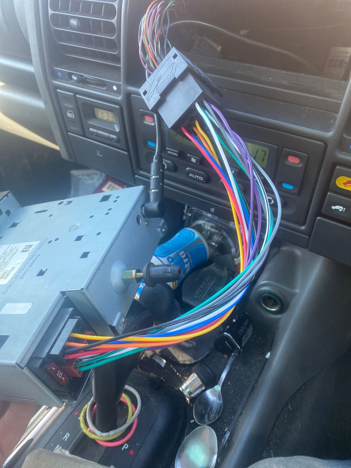

Thanks for your messages. I have checked and I don’t have an amplifier.
wiring is not my strong suit, so sorry if these seem silly questions.
would it be as simple as just buying a second hand disco amp off eBay? Will the wiring be under the seat ready for it, or would I have to wire it myself? If so does anyone have a wiring diagram? Or could anyone explain in relatively simple terms? Thanks once again.

Hard to know if you have the wiring or not. The stock amp has a single, large plug going to it -- I believe it's grey. Wiring diagrams are freely available in the RAVE and the D2 Electrical Library.
It looks like there are some pins missing from your old plug and the harness going to the new radio, that would be needed for the full functionality of the new system. This is probably also why your steering controls aren't working.

OP, judging from what I see already it looks like you do not have the CD player or the rear headphones jack harnesses running up to the radio and that's why the big block at the top of the new radio's connector is empty. And after a little digging, the large radio connector you're showing coming out of the dash with the adapter connected to it looks like it goes directly to the speakers so I think you're sunk with regard to the amp wiring. Best bet is to buy an aftermarket radio with an internal amp and an adapter harness to connect it to your truck's existing power and speaker wiring.
