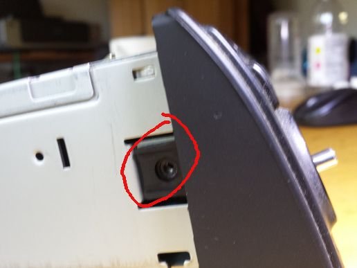

Basically, take the radio out, and remove two screws to get the face plate off. Remove the volume ****. Make sure to take the face plate off facing the floor, otherwise you'll have buttons all over the damned place. You might need to pry the edges very gently while you pull the face plate off.

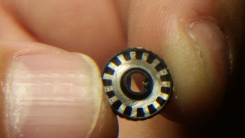

This is what the gear/contact wheel looks like:
If you look closely at it, you'll see traces of where dirt has built up causing the intermittent problem of the **** turning but not adjusting the volume:
This contact wheel needs to be cleaned. I started with a q-tip to get the little bit of dialectric grease off, then used a very fine narrow sanding stick to gently remove all traces of the dirt and grime to end up with a clean contact wheel:

im assuming you know because you’ve had yours apart my volume **** the coating came off and looks really horrible so I got a new ****..if it ever gets here to switch it out with...do I have to take the faceplate off to just switch the **** part? Have the same head unit but I can’t find where the screws are to take the face plate off

Screws are on the side of the chassis. You have to pull the head unit out an inch or two at least.
