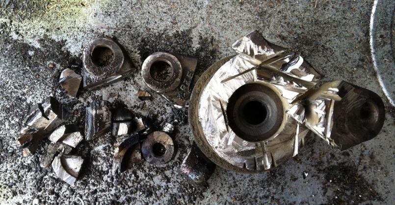

Attached is the picture of the carnage!

You don't need that tool. I drove my rear end up on ramps and chocked the front tires. The diff will not move. You only need that tool if you put it on jack stands or a lift.
The bolts for the rear shaft are 3/8 UNF I think 1 1/8" long. Microcat doesn't specify length.
EDIT: Previous wrong part number!
Land Rover Part # FRC3602 (superseded
Superseded by LR045926) 3/8 UNF X 1 3/4, Flange to Propshaft

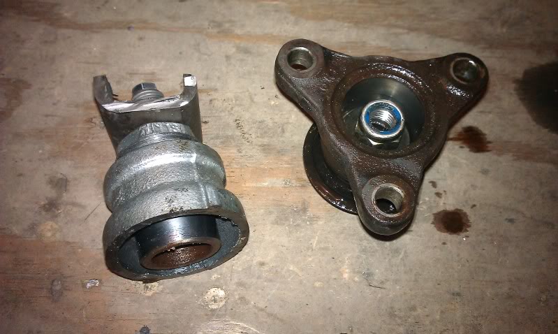

Ashcroft suggests drilling and tapping the hole to 12mm.
DiscoWeb Message Boards - View Single Post - Rotoflex conversion nightmare
Do this and make a puller. I used some reducers and other junk from the local Home Depot. Use a few high quality bolts and change them out, don't want to shear one off. Use a lit of heat. You'll get it out.
I don't own any of them girly cars with rotoflex....
