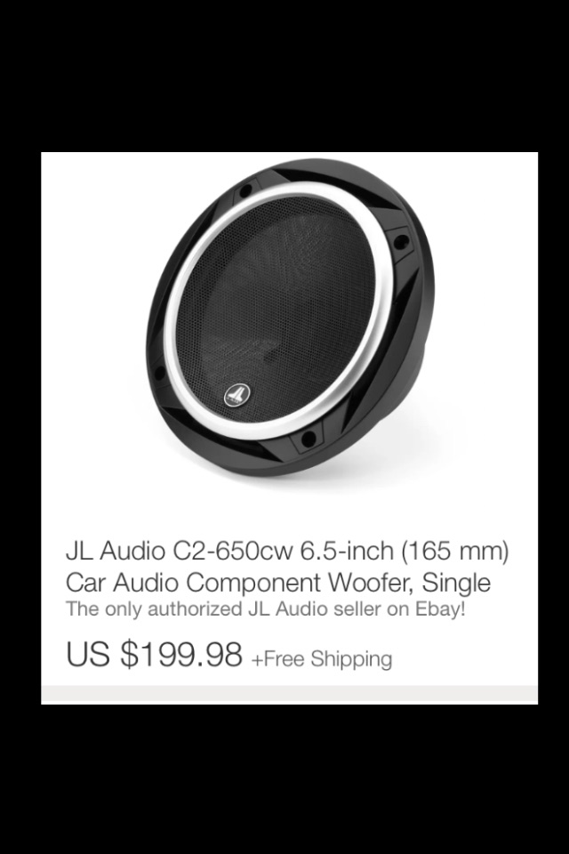

I literally just finished installing a pair of 6.5" dedicated component woofers into the rear door HK subwoofer housing and when I say exact fit, they are 100% compatible with the housing for this particular Sub. No modification whatsoever. The sound is simply night and day. My next venture is changing out the front and passenger main speakers with new JL Audio fitments. The door and pilar tweeters are excellent so I plan on leaving well alone. My intention being leaving the stock hi line Becker traffic pro system as is and update the speaker system only. That's my preference as my C300 comes out of hibernation soon.
I wanted to share this as I have read alot of mods people have done to fit various brand name woofers in the stock housing, others building extensions in the door panel, etc, but for those of you wishing to maintain the stock appearance and obtain superb bass as designed, these woofers are the answer. See pics attached, one of them shows the model of the JL Audio woofers which I bought on Ebay through JL audio. The other photo shows stepwise fitment. Took all of 45 minutes from open to close and half of that was wiring up the new woofers with post clips. I used the oem harness male and female. Hope this helps any of you interested who have the rear door subwoofer system in your rig. 👍

The woofers come in pairs where I bought them, JL Audio C2-650cw is the model.

What did those run you?
nevermind. Just saw the second post

200 bucks a pop...must be nice...

it's $200 a pair, granted that is still pricey but you get what you pay for in this regard

These are about $200 for a pair. These are the mid bass drives that use to come with one of the JL component sets.
They must be clearing them for a new model coming out, that is probably why they are offering them individually. The FS on these are 57hz. Best you are going to get out of these in infinite baffle config is about 70hz. Still much better than the stock.
The actual JL 6.5 Subwoofers are 6W3v3. These are awesome, will not fit without a lot of modifications, and will require a amplifier upgrade. The JL 6W3v3 are about $200 per woofer.
cimomd, this is a awesome find. I don't think this will last much longer. These are good for the rear subbox and PERFECT for the front doors. Wish they were available when I was ordering for my audio upgrade
