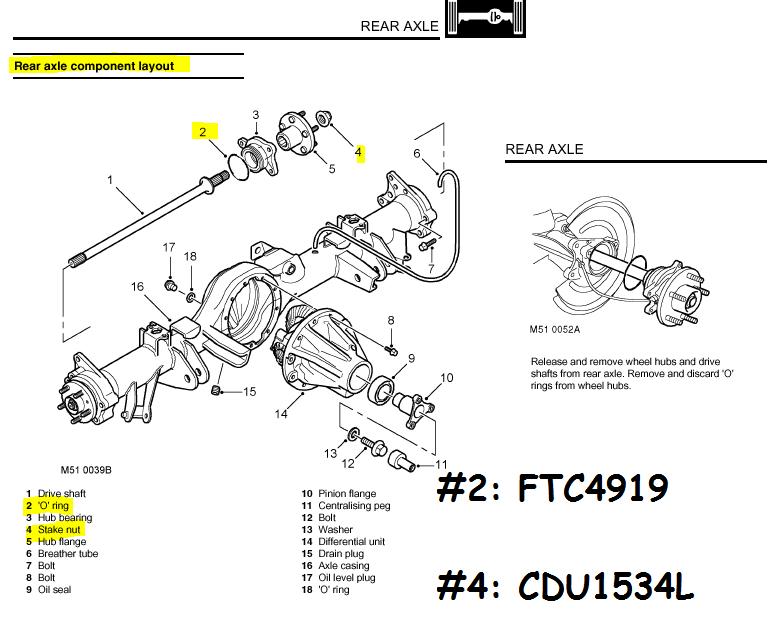

I'm sure you know this, but remember to replace the O rings (FTC4919) > O Ring Rear Hub D2 (FTC4919 Same Fit As Part # FTC4919 ) - Land Rover gaskets and seals from Atlantic British . I replace the axle nuts (CDU1534L) > Nut - Axle - Front & Rear (CDU1534L Same Fit As Part # CDU1534L ) - Land Rover hubs from Atlantic British as well, but it's your call. Good Luck!

The warranty is the only thing that has me leaning toward the cheaper hub. 70 bucks is pretty cheap though! since is quite easy to disassemble I'm more willing to roll the dice as well. I will replace the oring for sure! To bad that wasn't what the leak was but when you see grease you know what that means!
