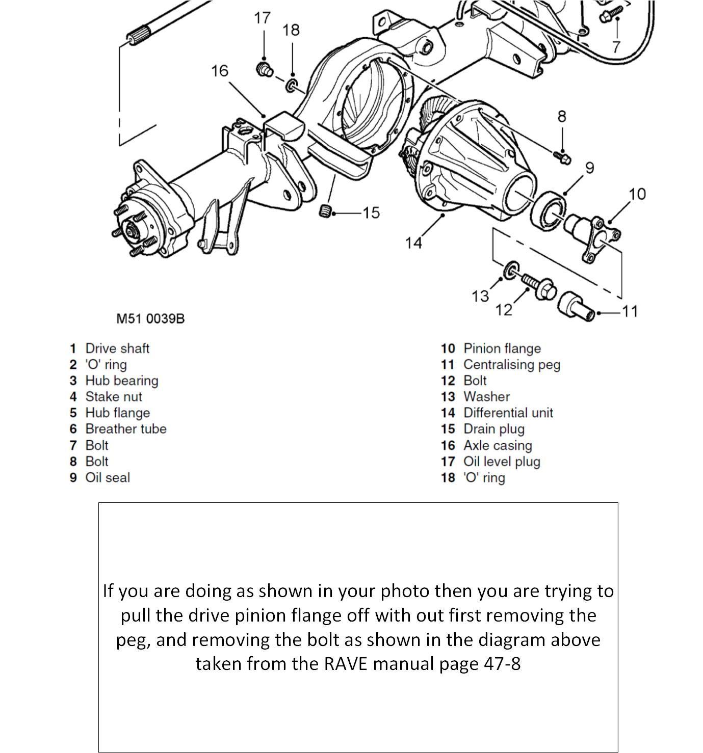

watch this, you need to pull out and remove the peg first,... then undo the 24 mm nut /BOLT thats behind the spigot that holds the flange in place on the drive pinion , its this nut/BOLT you cant see that causing all your bolts to keep break, your trying to pull the flange off the drive pinion without removing the drive shaft flange BOLT which is behind the centalising peg,
what the video I have posted

yes if you have watched the video , first you need to adapt a socket to pull out the centalizing peg as shown in the video, that lets you get to the nut/bolt holding the flange onto and into the diff
OK
1 pull peg
2 undo nut/bolt and remove
3 remove flange
