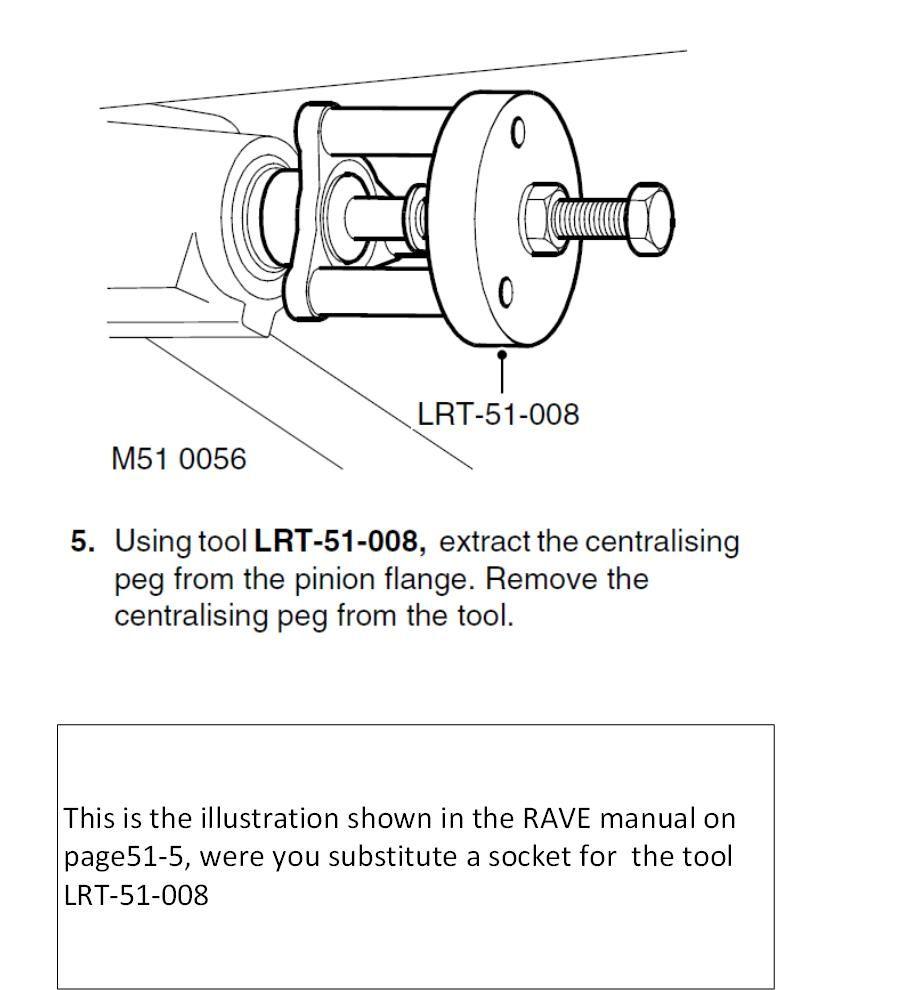

yes if you have watched the video , first you need to adapt a socket to pull out the centalizing peg as shown in the video, that lets you get to the nut/bolt holding the flange onto and into the diff

yes I do because if you look at the photo he posted he is using the puller to to pull the 3 hole flange and push against the peg have you watched the video the flange wont come off as it bolted to the drive pinion the peg is a push in tolerance fit , it clearly shows a socket used as a distance piece, then a suitable bolt with a nut, then a few washers on it the bolt is then passed through the socket and screwed into the peg, until its tight, now screw the nut down the bolt against the socket an pull out the peg

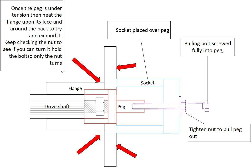

HI again, if you have the puller under tension which part are you warming up, it should be the flange, to expand it and let the peg go, see attached drawing

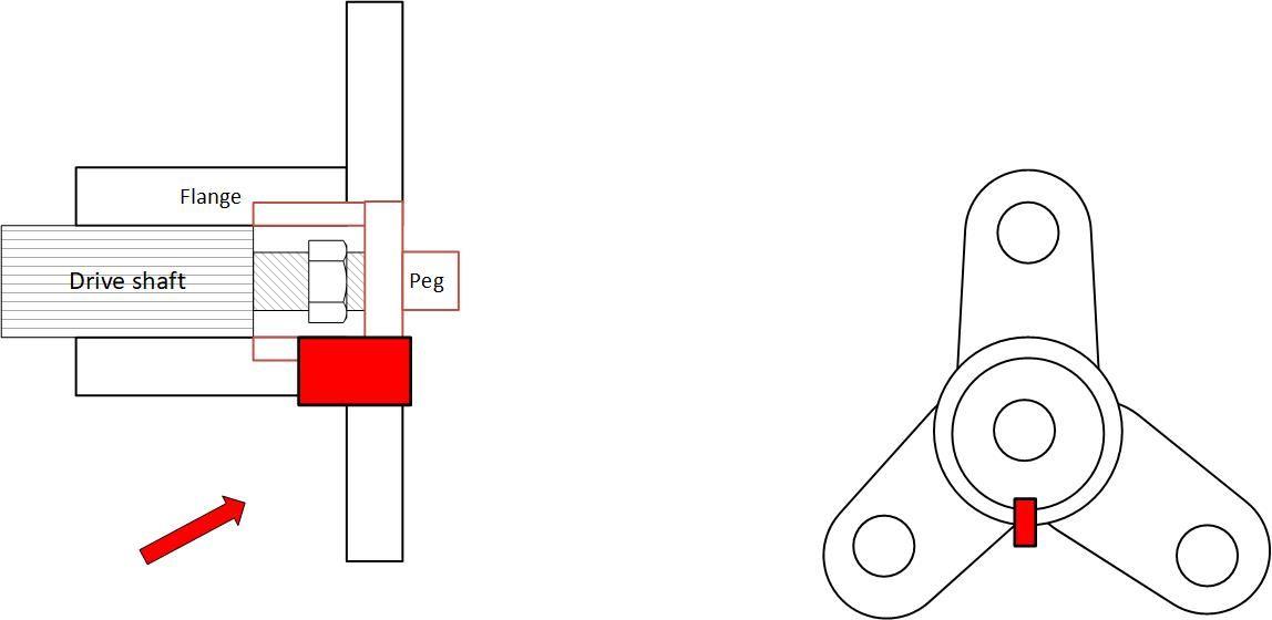

OK so as you don't have a welding machine, and I don't know what type of heat gune your using , if this does nor get it off, then you may need to slice and dice it take a cutting grinder and start to remove the flange
I take it you are going to replace it so cutting off would be the next thing to do, make one cut in between the flange legs from the front cutting into the base of the peg and the flange
taking it slow start to cut into the flange as shown trying do to go in to deep as you dont want to damage the shaft when you think you have managed to gut through if the puller is not on re attach it as try to pull the peg again the heat from the cutting may help the peg to loosen its a slow careful job

Thank you frostythor, the diagrams are very helpful to visualize. I need to pick up longer bolts and stronger nuts and I will attempt again tonight after work. I've applied heat mainly at the flange from the front, last night I figured before I go to bed I'd try to turn the peg red hot (close but no cigar). Really trying to avoid cutting through the damn thing but I will.
Did you just put those drawings together? I've never seen those before aside from the RAVE one.

HI again , Yes I sat an did the drawing only took me 15-20 mins, I use to do a lot of drawing an how to do things when I worked Offshore as a Deep Sea Diving Supt, hence my logo
you mentioned you got the peg red hot last night, if you did that could have broken the grip, try the socket puller again, get it tight then start heating up the flange face keeping the heat away from the peg body, and behind the flange keep trying to tighten the nut as you go , I dont know but I would think your not using Oxy-Acetylene torch( Gas Axe) are you
