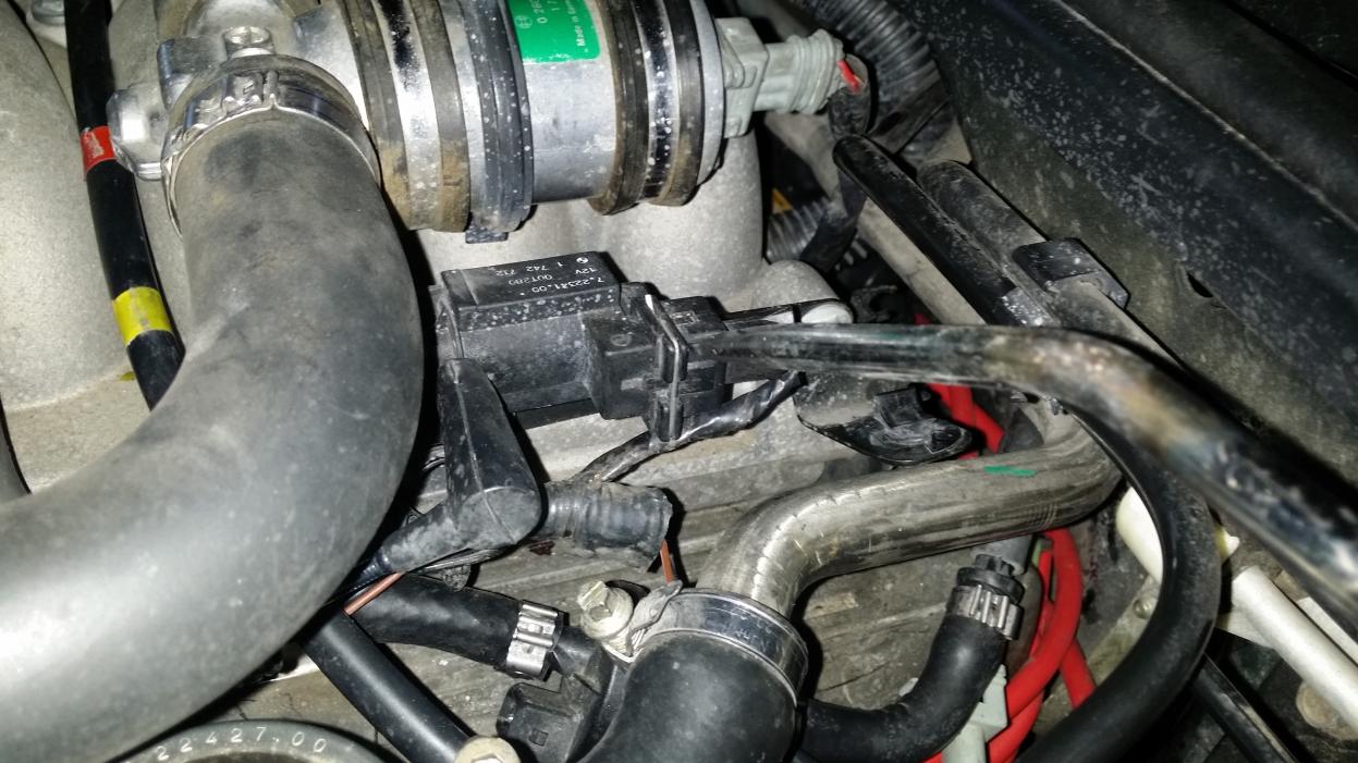

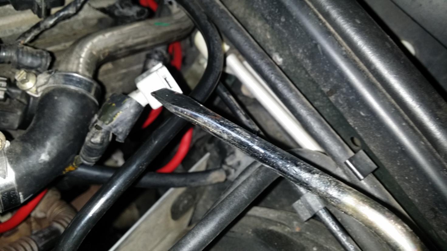

And another
Attached Thumbnails  Replace Wires Without Removing IM-20140305_070532.jpg    Replace Wires Without Removing IM-20140305_070637.jpg
