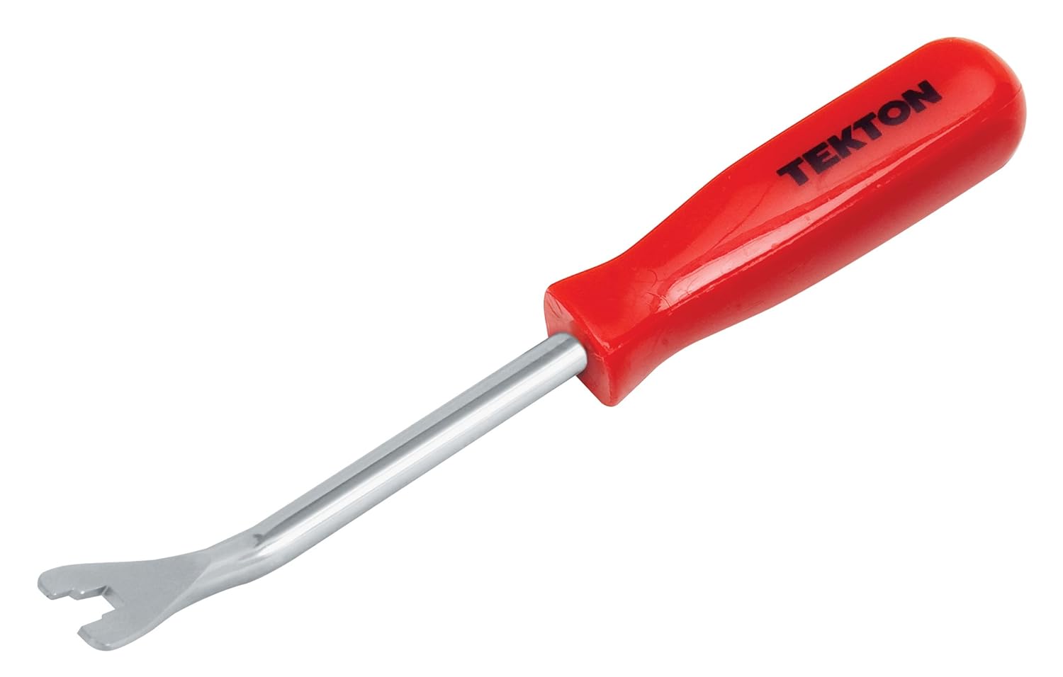

BAM DONE! not too difficult! I do have 03 Disco with SAI .. just pull a few items off like stated and I used a metal bent slotted panel removal tool! looks like a screwdriver but has v but out of center and a little wider at tip... but basically screwdriver size ad stated above.. BAM was pretty easy! This was my first time changing plug wires on my discovery even though I've done lots of cars in past ... once SAI stuff was off... my Kingsborne 8mm blue wires snapped right on! i would ave gotten magnacore but back a few years ago when supposedly stealership put new 7mm wires on, I didn't do it an was already over budget so ordered the Kingsborne and there they sat.. year after year.. finally I took a FUGITOL and BAM! 2.5hr job! clean up and search for tools 30 mins total 3 hrs ! and NO CODES! I was pretty sure I had bad wires or plugs... I did replace 1 plug and waiting for my platinum +4 to arrive and Ill switch... however I do have a set of iridium so Ill ask here which I should use... I heard the platinum _4 were being phased out so I bought them just in case... ! also noticed a few loose clamps and battery terminal leads were not snug ! when checking voltage before and after job... I was getting 13.6 ish on the UG and now 14.6!!!!! I full volt more!
[UPDATE] Everything is running smooth... the voltage difference seems to have just been at initial startup and has been bouncing around 13.8 to 14.2 so I do see a little better there... the engine is running smoother but I have thrown a couple codes I was already getting.. 0134 / 0135 / 0155 ... I know after looking that I do have some mix n match spark plugs.. I just noticed I have a Denso in Cylinder 1 and I swear I put all new iridiums.. maybe I did half of them because my local store was out... its possible but that was a few years ago so I don't remember... lol Ill check them when my new Platinum +4 arrive
Amazon.com: TEKTON 5873 Door Panel Remover: Home Improvement Amazon.com: TEKTON 5873 Door Panel Remover: Home Improvement
