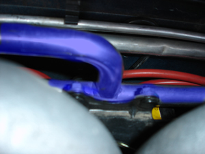

for this pic, which nuts were removed, the ones facing the wall or the nuts next to the IM?
tomorrow I'm buying a 10 mm wrench, don't have one. I can't get a socket down there.
also, being the cheapskate I am, I ordered the regular wires from atlantic british. reading everything wish I would have bought the magnecors, but it's too late.

Originally Posted by waffle blossums
awesome thread, thanks!!
Send the wires back to AT and get some good 8mm Magnacor wires which they don't carry.
You install something else, they will turn around and bite you.
So, not wanting to read all the posts, do you have SAI and do you think you can do this without removing the manifold?
