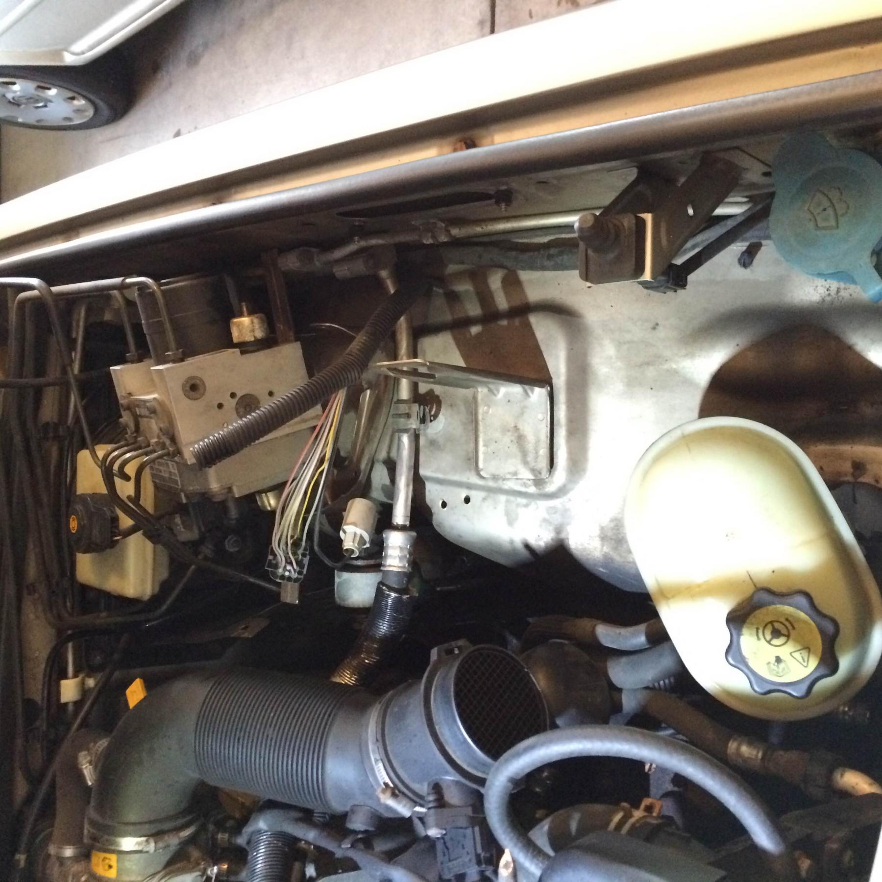

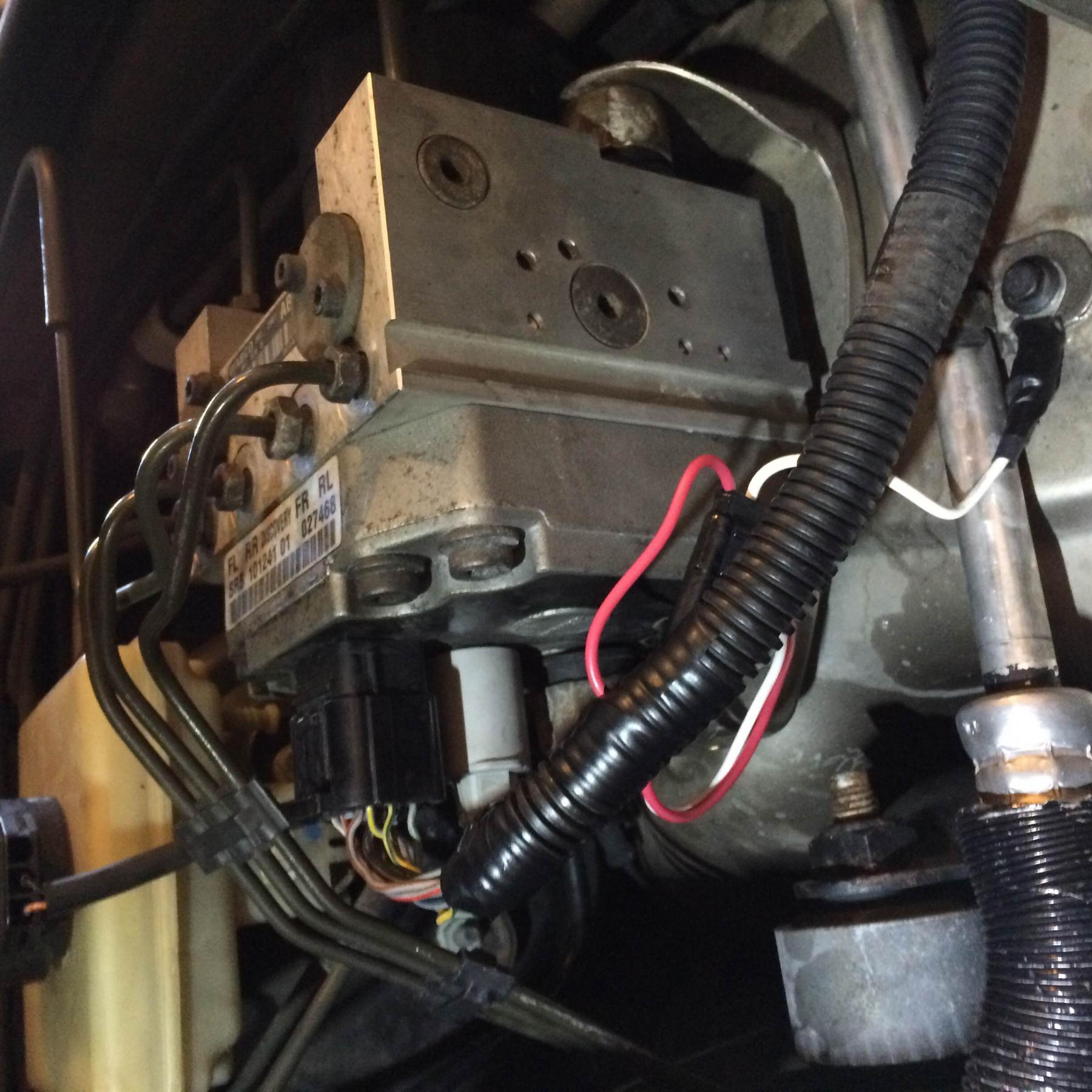

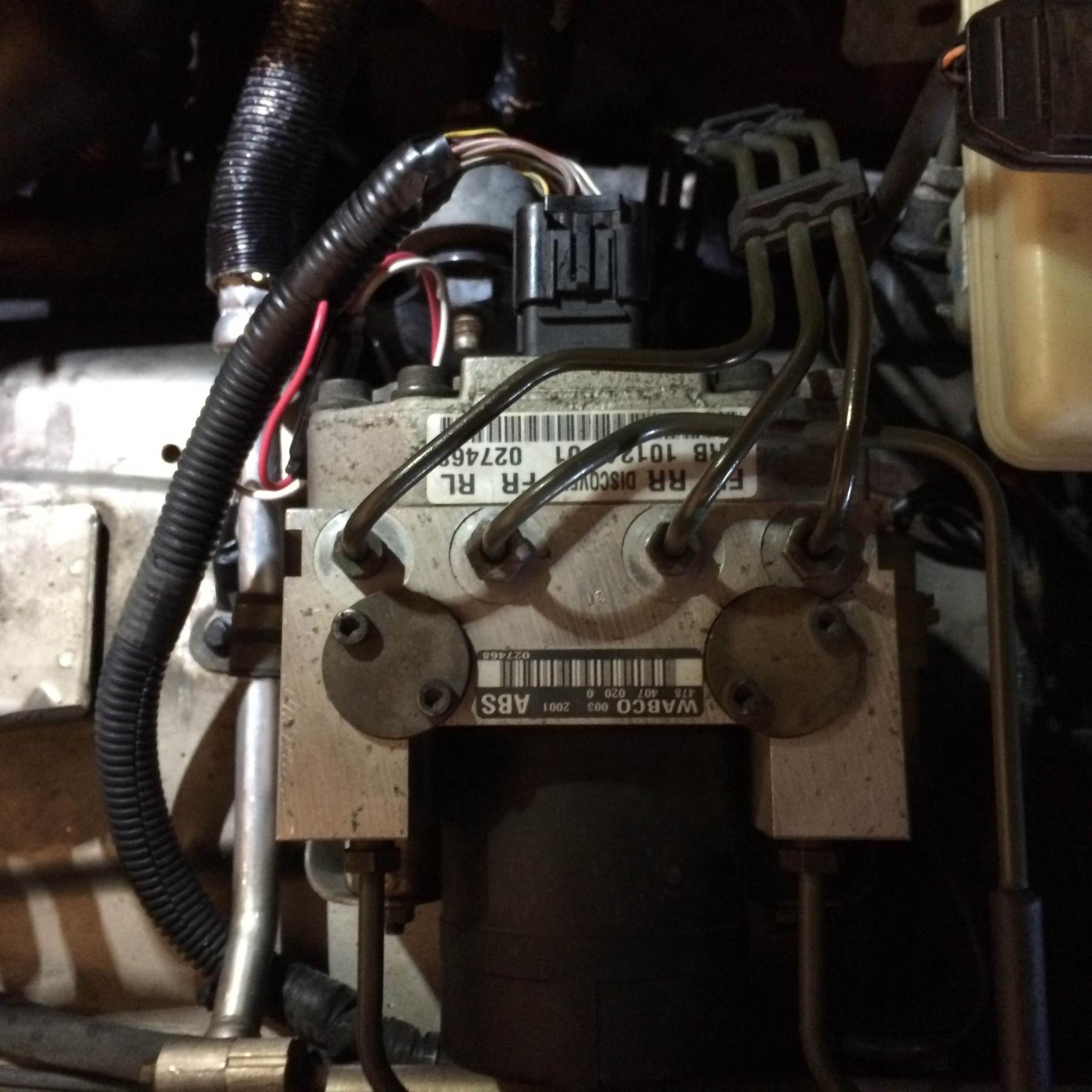

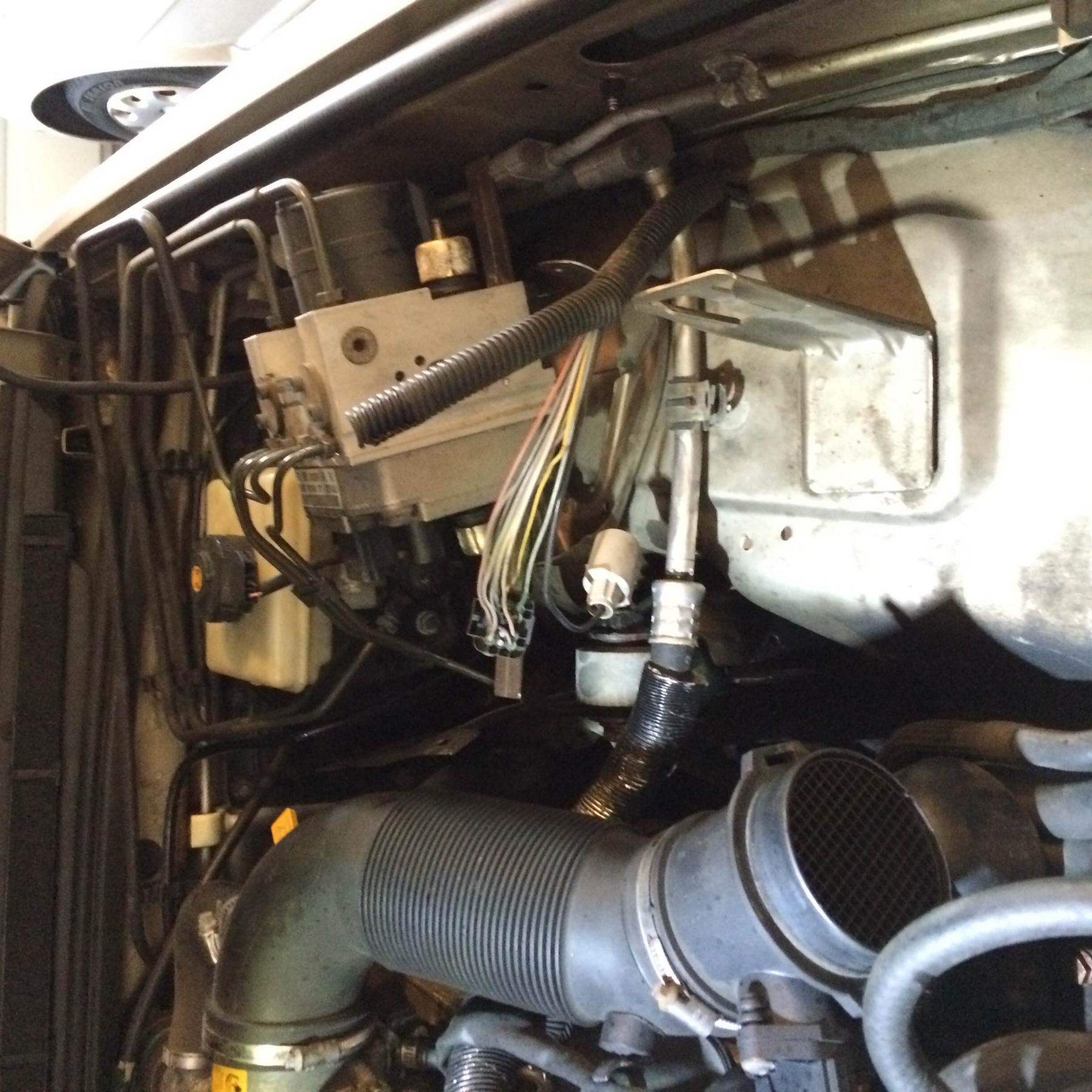

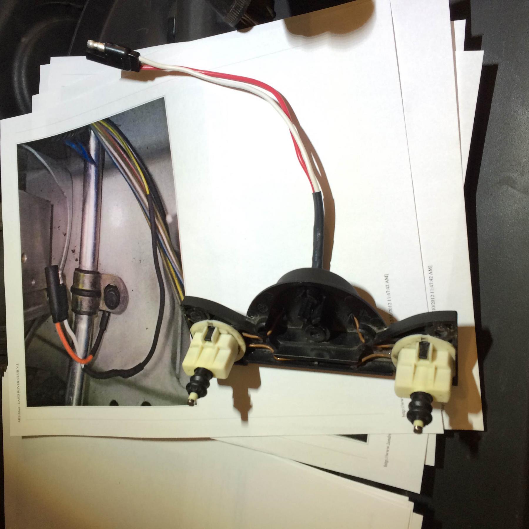

So after following the advice of min01 I have re-read the article by Josh and decided to do the Opt B mod. I have just completed it and found that it was not as difficult as I thought. Didn't remove the ABS Modulator... just raised it as discussed in the article.
I did find the some of the clips were brittle and snapped (ugh) but doesn't seem to cause any issues. Here are some pictures from the 'procedure'.
Now comes to waiting... will the 3 Amigos disappear?? I hope so. Next project / need to do is the engine. Front cover, HG, etc etc.... here is hoping that I don't run into any 'really' bad issues on that one. Love Land Rovers!!
Cheers! thank you for all the great advice / time that you put into replying.
