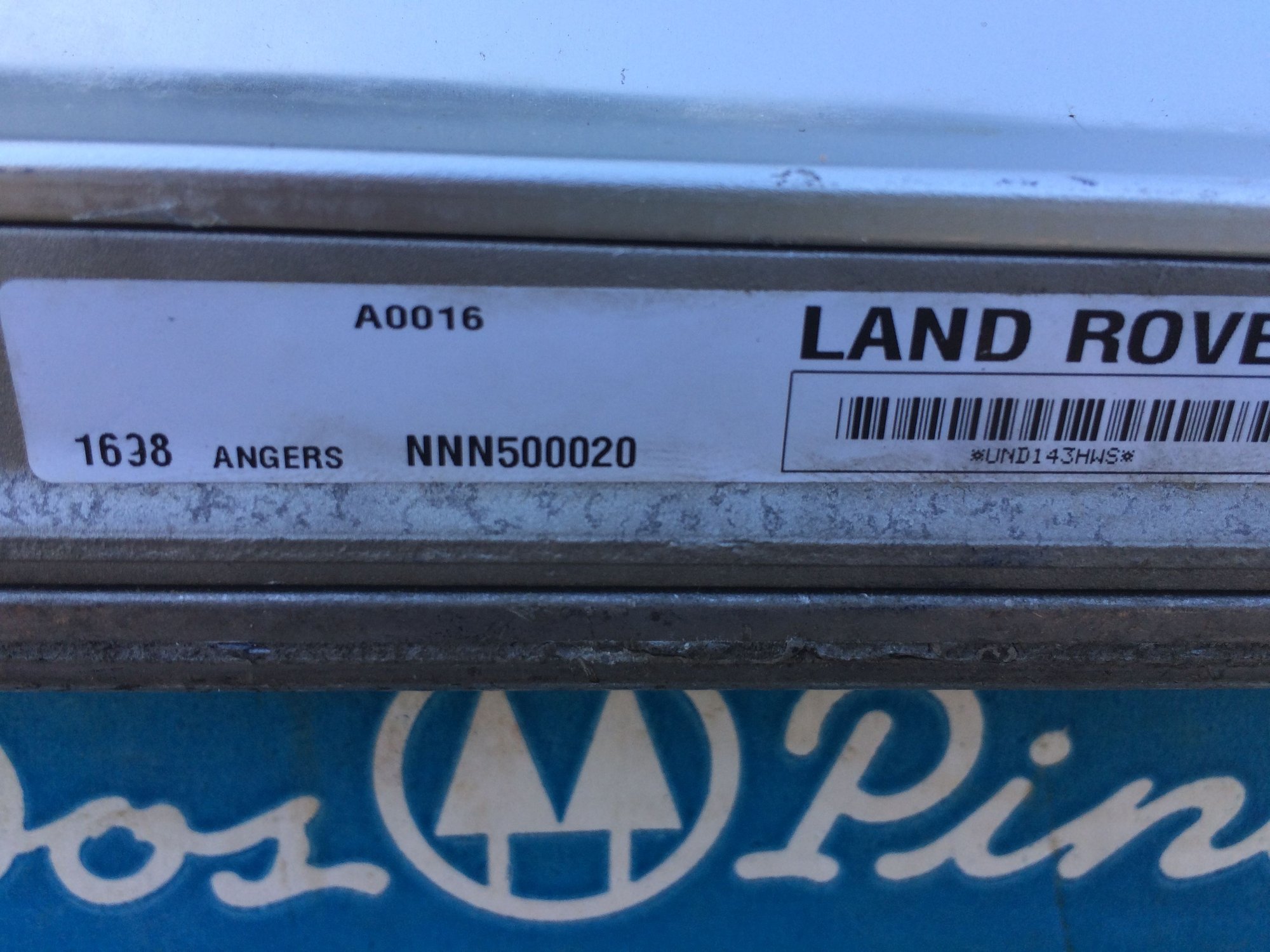

did you get an angers unit NNN500020 reprogrammable / usually a braker will have a discovery, normally (unless some has locked it) they require nothing more than installing and cranking the car.

no way.... so what did you do to discover this? I'm facing the same issue... but i've replaced my CPS twice now in case the first one was a dud
no spark, no fuel injection pulses either.... thought it was the ECU after that. put in a used one jsut like the other guy haha - now i know its not plug and play. should've read this thread before dropping so much money on the ECU....
