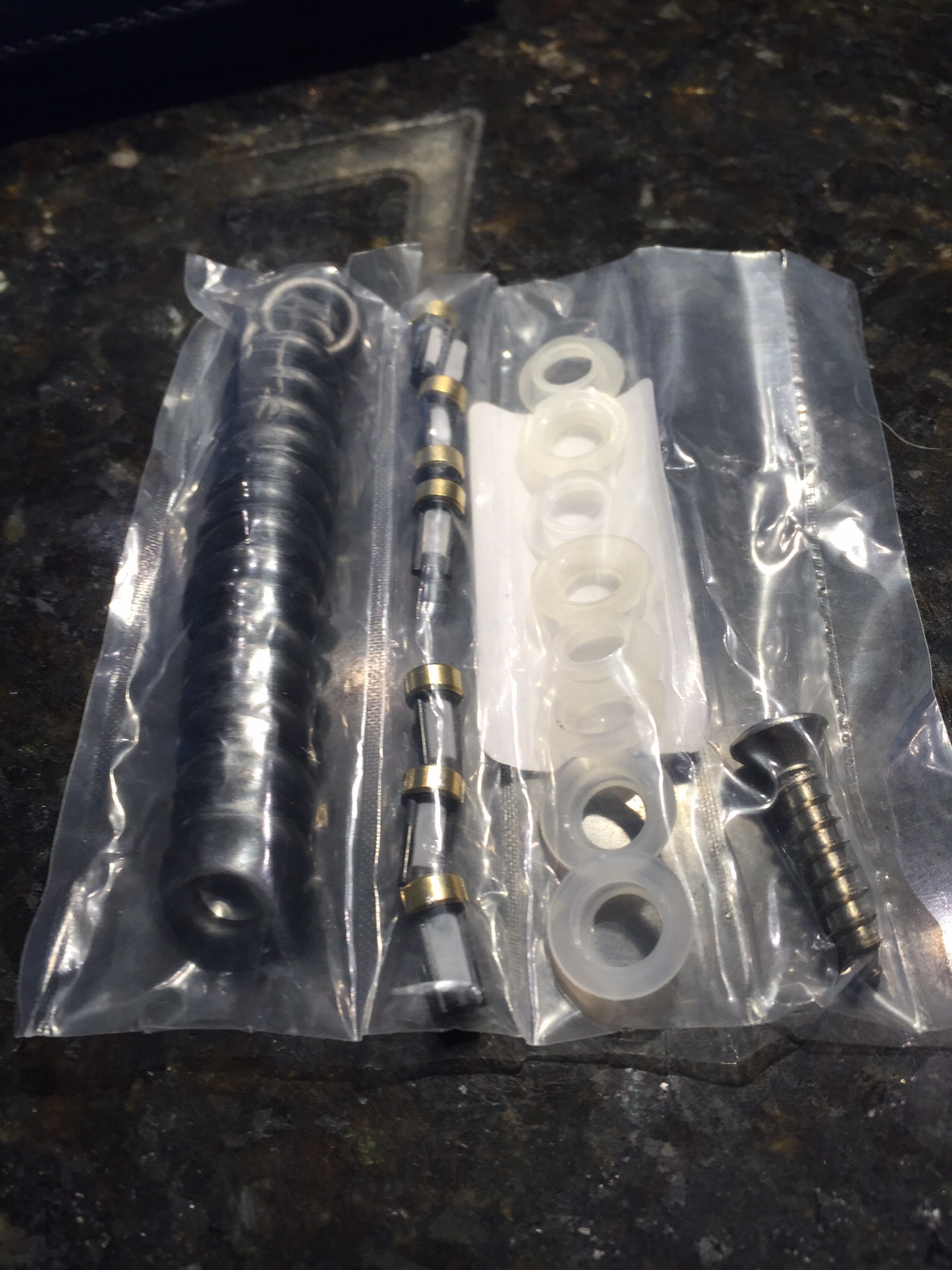

Ok more questions....the injector seal kit I got includes new filters (see pic). The instructions talk about putting a screw into the injector to remove the old "filter basket" and then insert the new filter.
Have you guys done this? Or should I just replace the 2 rubber seals and be done with it?
Those instructions sound about right. If you got filters, then I would replace them. They are in there pretty good, so using a small screw is just to grab them and pull straight out. Go for it and add the pics to the thread.

That looks like a nice kit with the hats too.

The instructions with the kit are pretty lame. I'm assuming that I don't put the screw into the spray end of the injector, right?
Any idea how to replace the hat?
