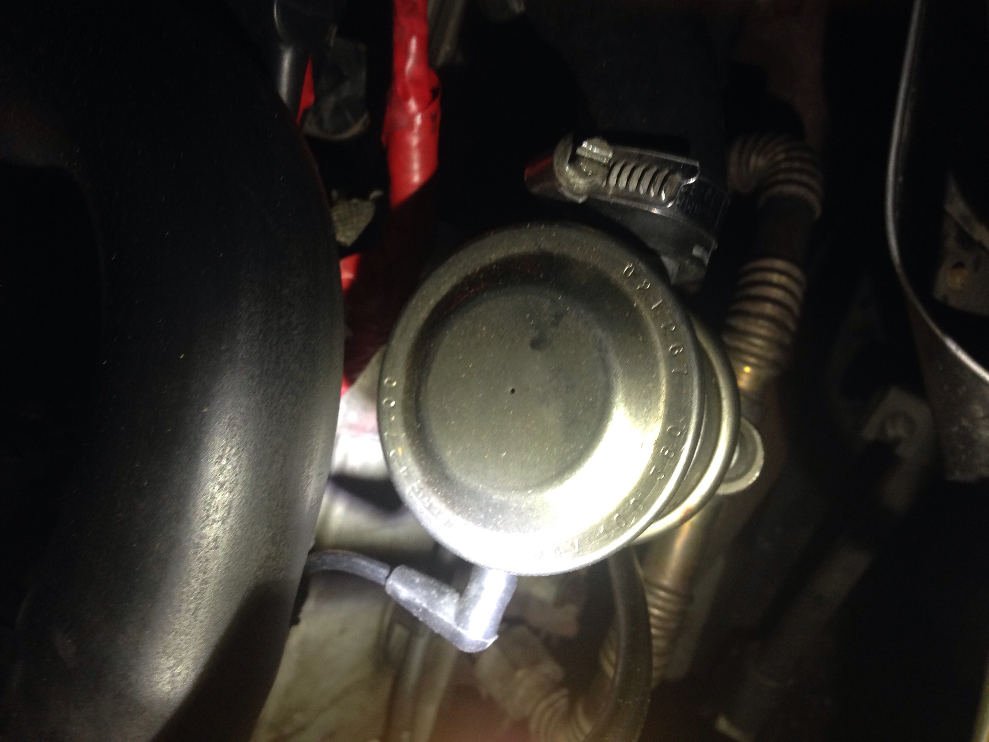

This small line on vac-reservoir to sol valve, like it says

This guy, #2, sol valve

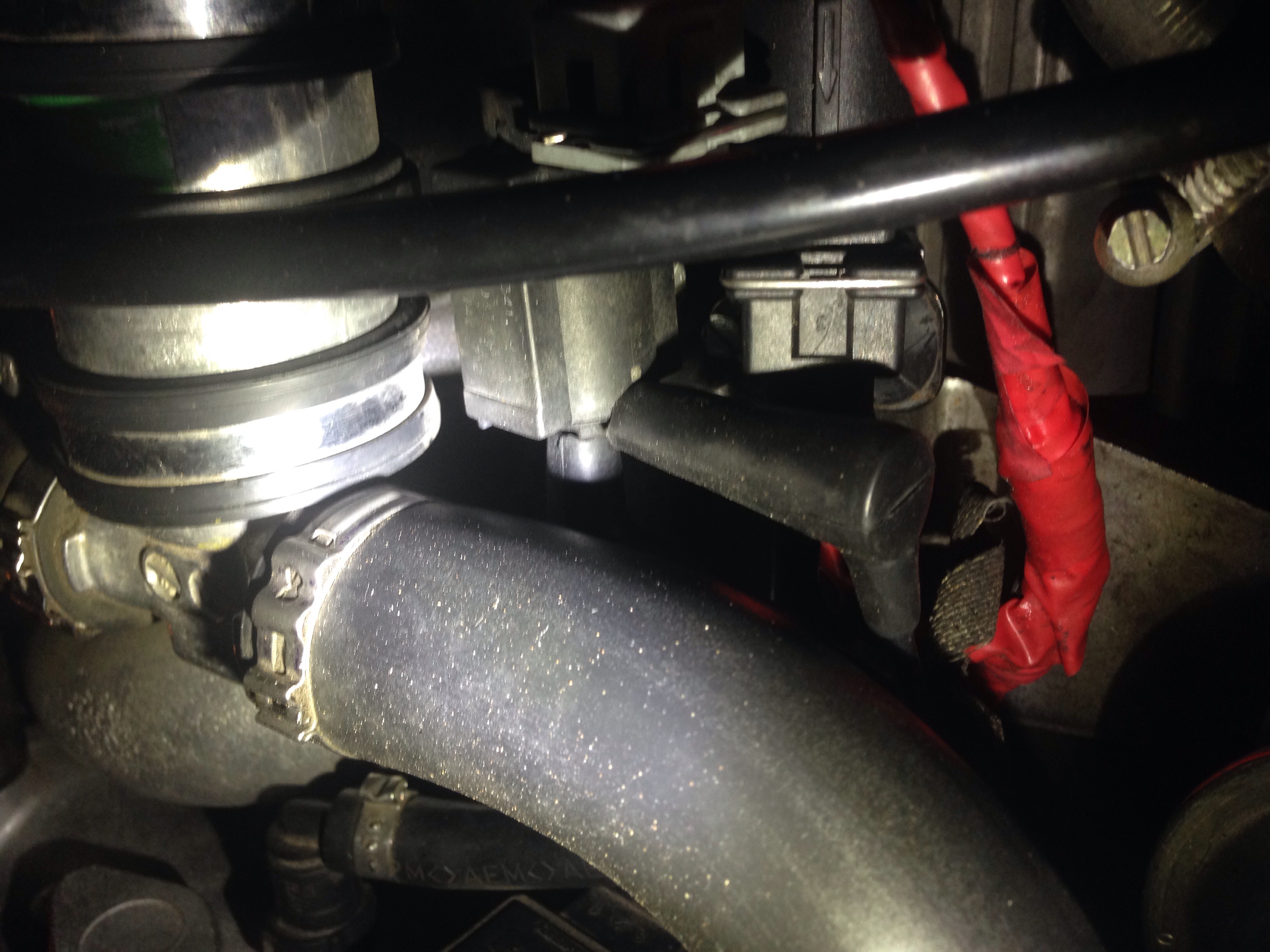

From: Dallas, TX
There are 2 lines connecting to it, they are angled so each attaches just the right way

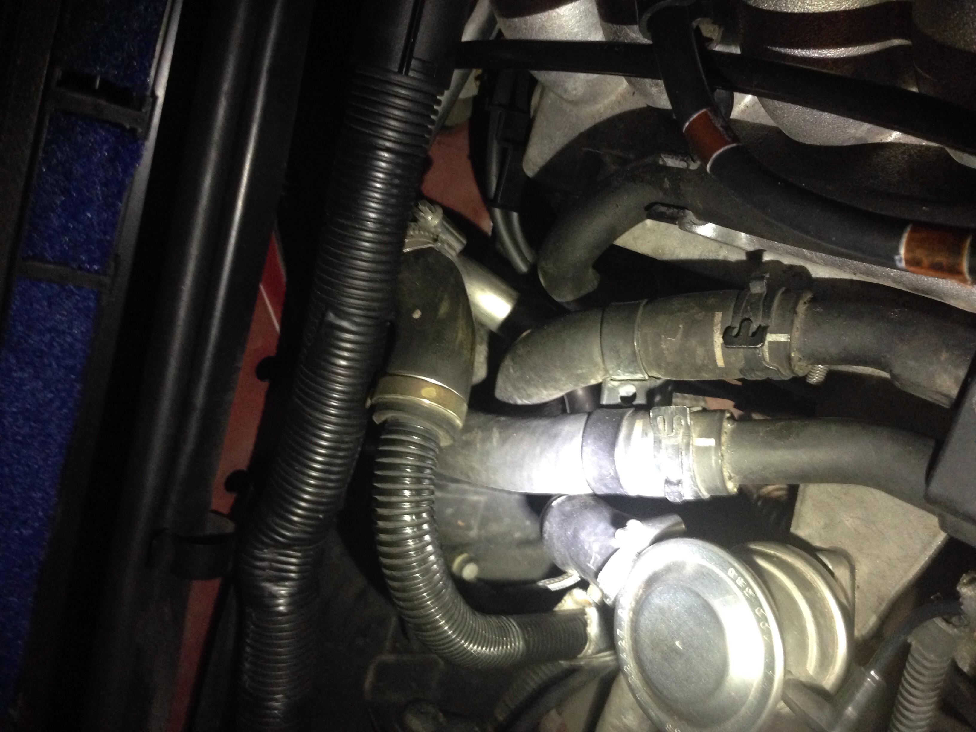

Crossovers tube on firewall to Pass side control valve and SAI pump. Loosen clamps and refit hoses. Then re-tighten very snug

From: Dallas, TX
Crossover tube on firewall to driver side SAI control valve, near SAI solenoid and its 2 lines where we started. One again, loosen clamp, reseat hose and tighten up clamp really well again.
