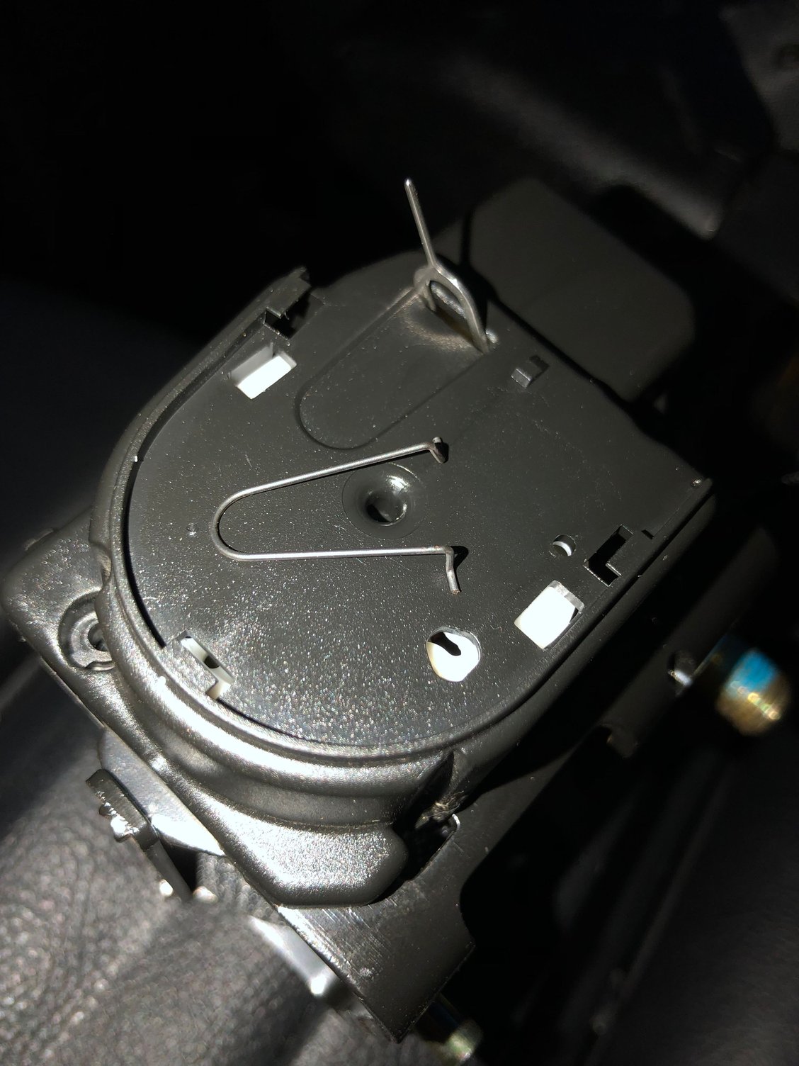

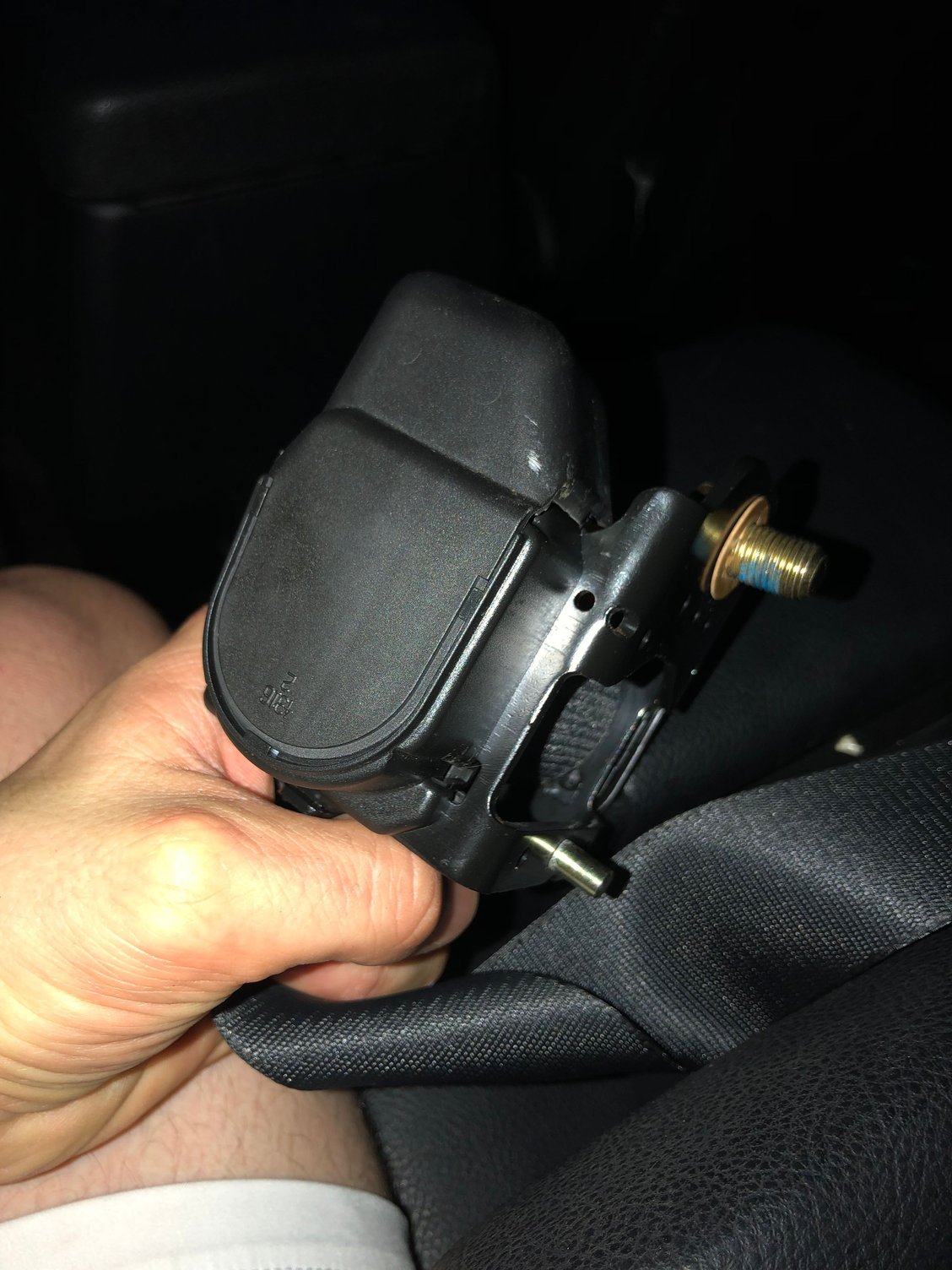

All, No need to buy another seatbelt. I had the problem last night and fixed everything in about 30 minutes. The PDF from DiscoDOS will tell you how to get to the belt mechanism. Take it off. Once off, you’ll see that One side has a flat piece of plastic (the part that holds the spring)...don’t touch that. The other side has a plastic cover and it basically slides off with a flathead. Once inside you’ll see a metal V shaped pin on the top...take that off. Now get a small object (I used the SIM card removal tool from my iPhone) and stick it in at an angle like the picture shows. It may require some movement but if you push it in it’ll disengage the seat belt lock so you can pull out the slack you’ll need to fix the belt. Don’t forget to put the pin back in. Mine works just fine now. I hope this helps. Thanks, Gary
Slide this cover off. Per the angle in the picture it will slide towards 2 o clock.
Stick the SIM tool in the small hole where the other pin was located.m, then push down and to the right.

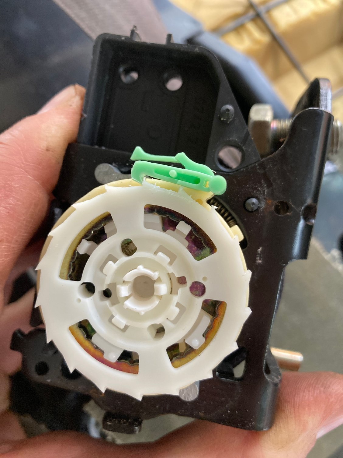

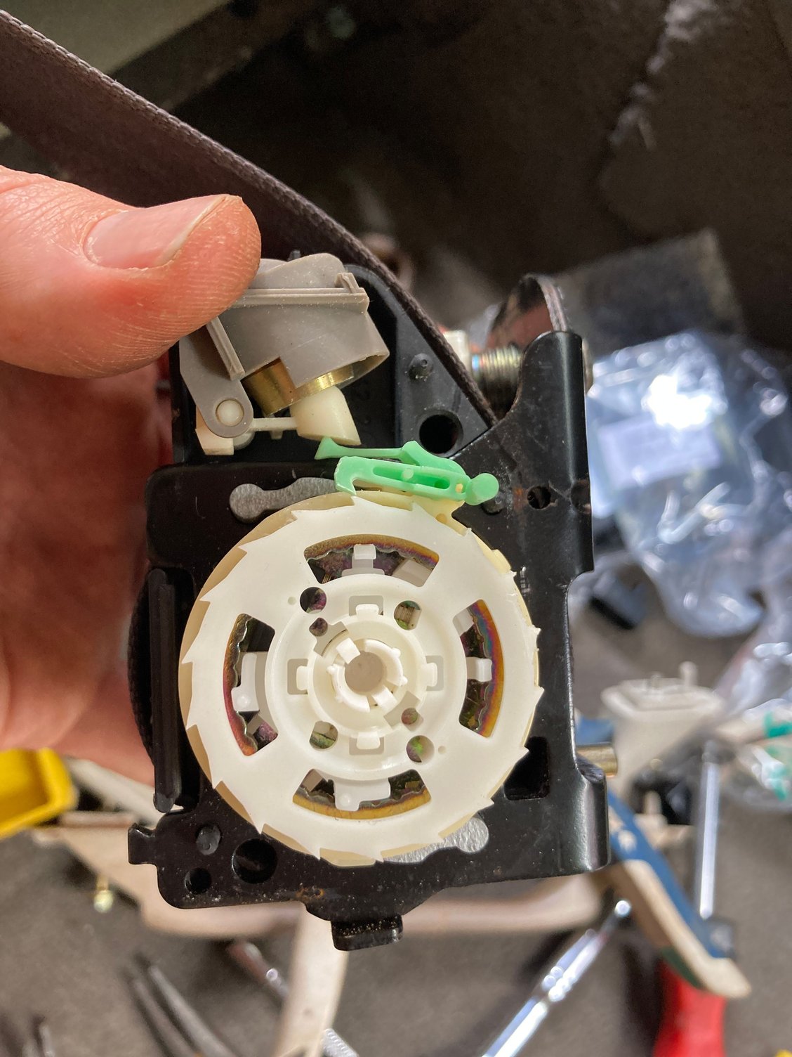

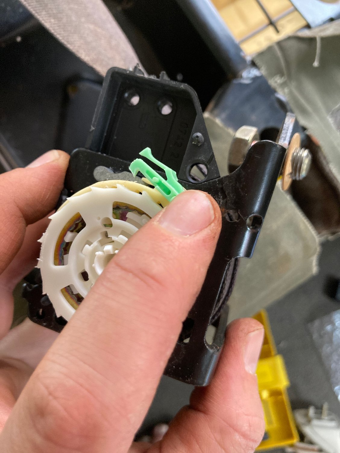

Some extra photos to help see what’s going on under there and see what you’re trying to accomplish by sticking the pin in there. Finally got mine released, amazing how that tiny plastic piece can be so strong.
