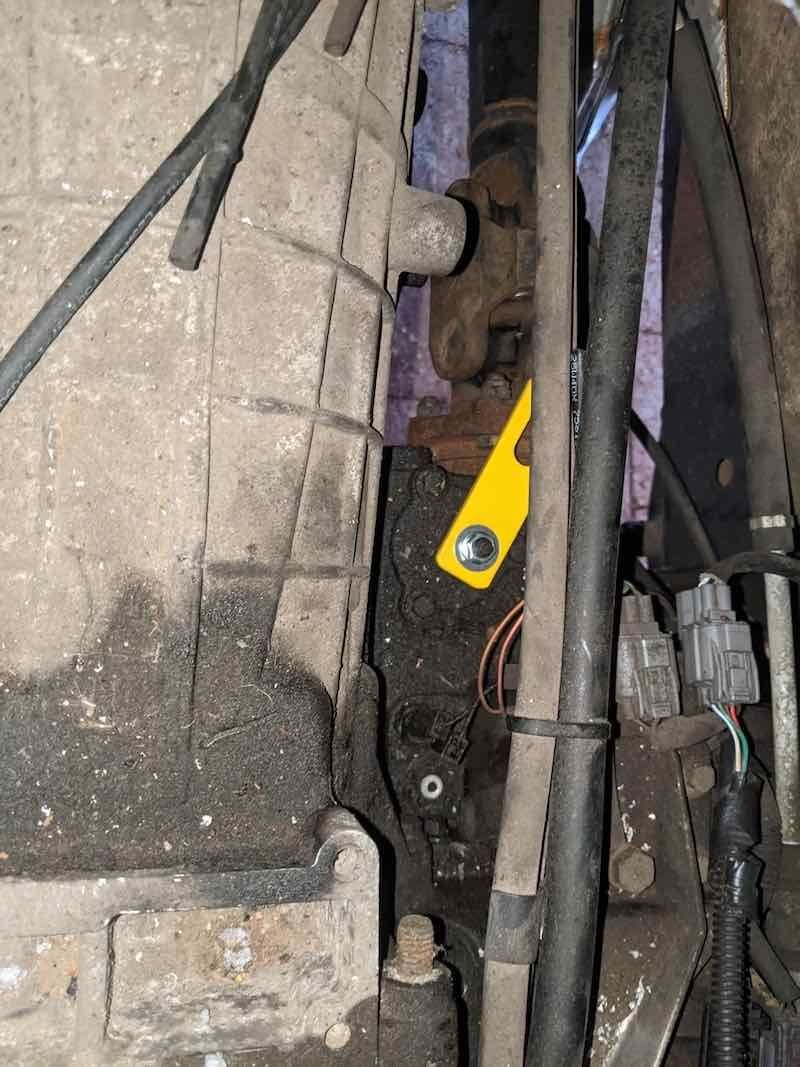

They definitely are. Sounds like you have a handle on this, but you have also mentioned that you have not historically been mechanically involved, so I am gonna share what I have learned about O2 sensors. I am sure I will upset guys way more knowledgeable than I. There are aspects of the below for comedic effect...I think they will be obvious.
There are four. Two between the engine and the cats and two between the cats the Y pipe that merges the exhaust before the resonator. They are called "Upstream" (before the cat) and "Downstream" (after the cat). The RAVE diagrams are on 17-2-56/57, 30-2-7, but they are a guide to someone that knows in this case, not someone that doesn't know.
Above you are showing the passenger upstream connector and bung. This is one of the two "easy" ones. The drivers side upstream sensor is harder to access because the engine is offset from centerline to the drivers side. As a result you have two break your wrist and your arm two places to reach the sensor and connector. Also, it is useful if you have two hands on the end of your right arm when trying to reach in there cause you need two hands, but two arms don't really fit.
The drivers side downstream sensor and connector are also easy to access. Right under the drivers seat.
The passenger side downstream sensor is easy to access. But the connector is on top of the transfer case. I have attached a picture of mine taken through the tunnel cover. Easy to get to after you have your center console out and the tunnel cover rivets drilled out and the tunnel cover sitting in your workshop. Not so much from underneath where you can see or touch but not both. The picture is to give you a mental picture of what you are feeling when you reach up in here. The sensor is the connector with the red, green, white wires. I had to re-wire mine and I already had the center console out so the easy button was removing the tunnel cover.
As you go through them, feel free to continue to ask questions.
