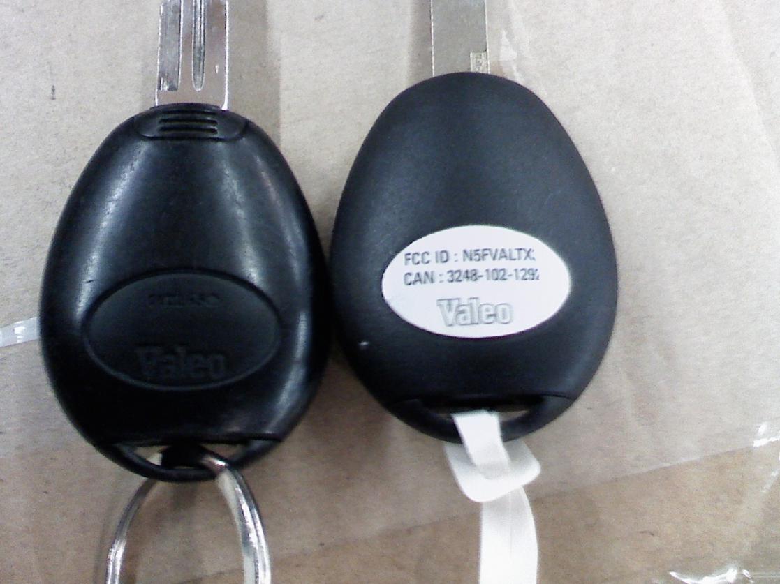

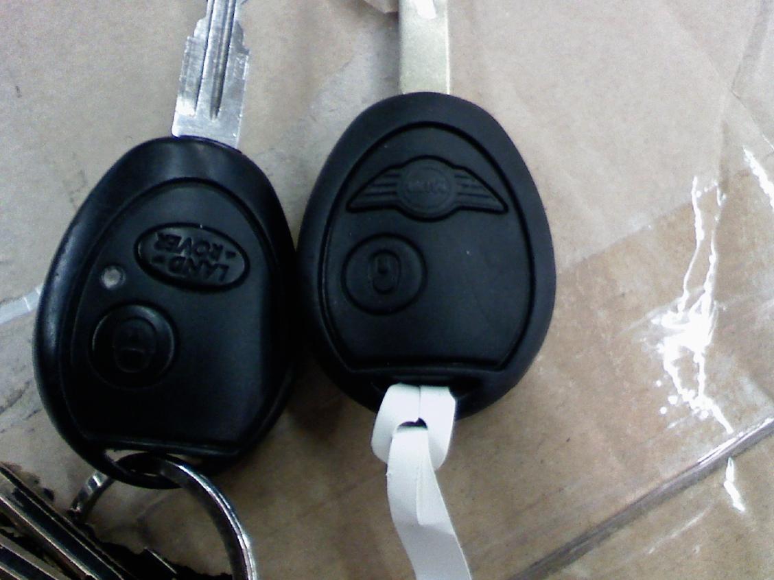

Well working for a BMW/Mini dealer for the last 7 years and since the birth of the new Mini Cooper....I can tell you from experience that the barcode MUST remain intact or the key is useless from a remote standpoint. Unless something is different from the Valeo Land Rover key to the older-style Mini Valeo keys......but I just checked one and they look identical to me. The Mini has to be hooked up to the computer and the barcode entered off the tag before the car will accept the key. Like I said, I could be wrong about the Valeo Rover key but that's the way it is here at Mini.
