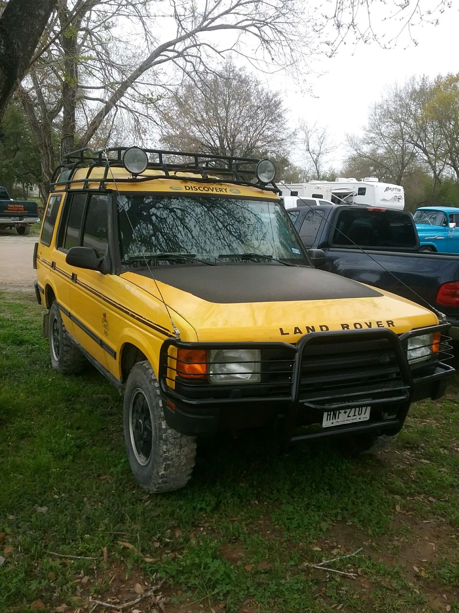

Yep it’s outta here, got it running/driving very well, but I’m looking into this! If it’s as good as I’m hoping I’ll probably make a jump I might regret later & sell my flawless 04 D2 for say 6k, and fix up the XD to my spec.
