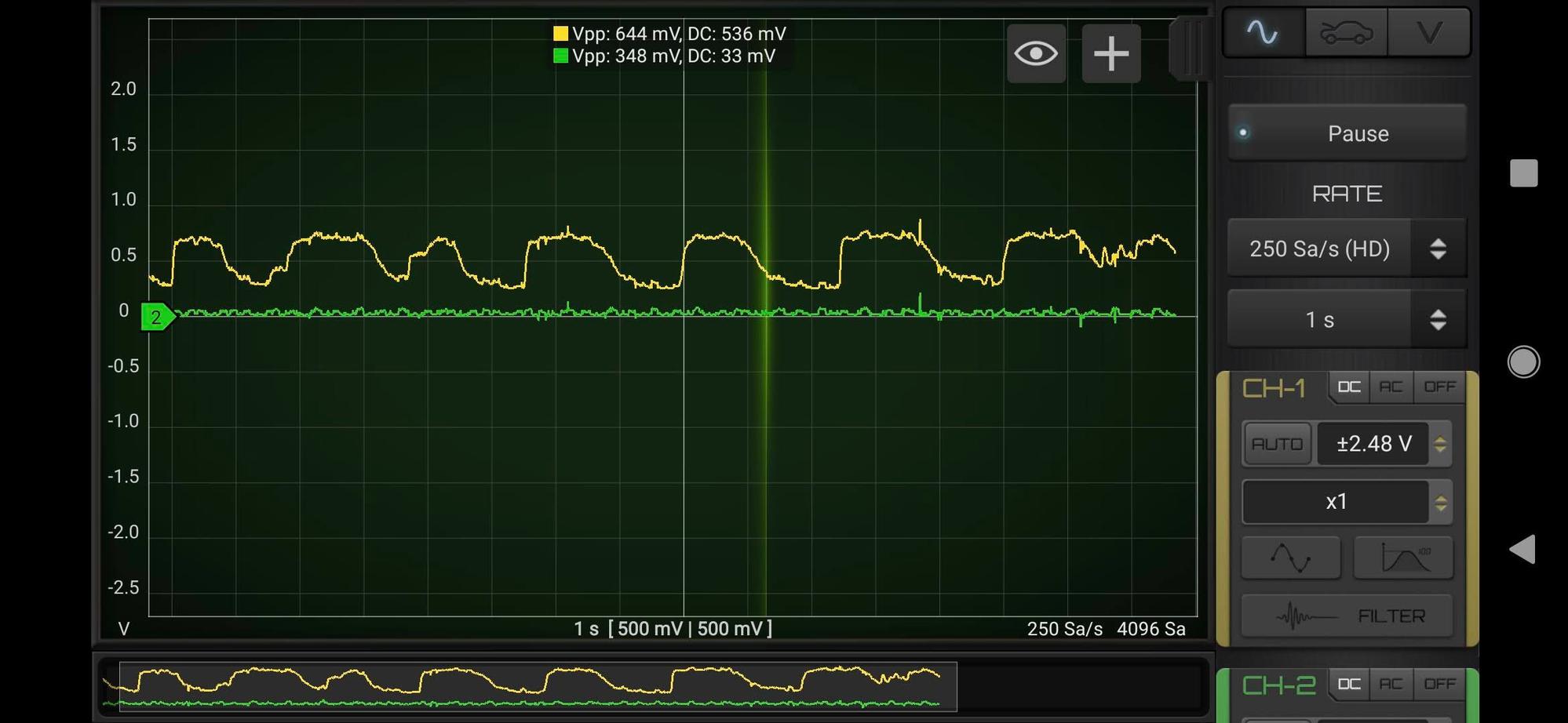

Do you still have the old ECU? Do you have any idea what in it went bad? I'm having the same issue on the other bank P0154

Looks like I found my issue. Removed and Opened up the ECU tested the "Earth path" for each of the O2 to see if there was any logic to that side of the circuit. They go to ground apparently without CPU/PWM management. The sensor I had been having issues with ,B2S1 p0154, did not have continuity to ground. I tried reflowing the joint but that did not solve the issue, and since the pin is buried under the Connector header block I decided to solder a jumper wire to ground. Now my issue seems to be resolved.
